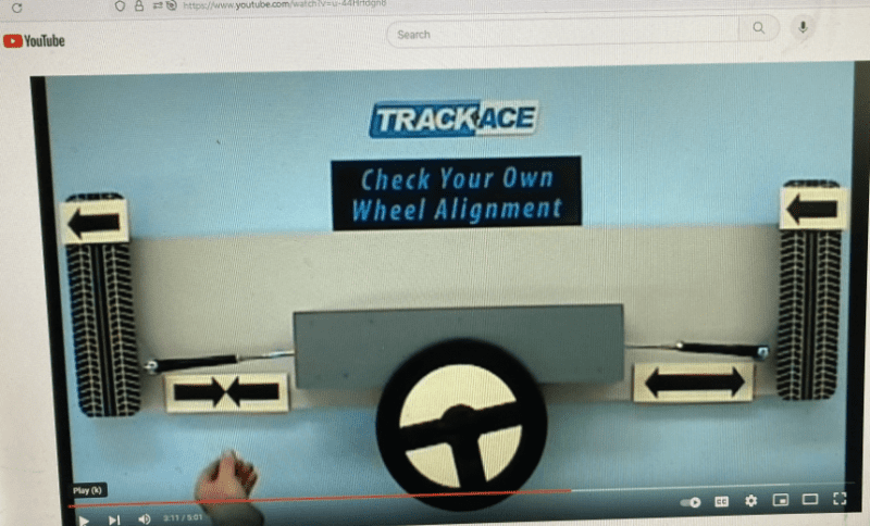

I made a post a few months ago about after my front end alignment the toe was zero and the steering wheel was off center. In the past two months I've been reading posts, watching videos, and bought a home alignment kit. Everything is now sorted and I will never take it back to an alignment shop without serious references from the mopar community. Took me a while to get my head around centering the wheel, but this video made it really simple. Just things I'd never had to think about before -- but once it sinks in, it's pretty straightforward.
Here's the link to the video and a screen cap of the centering portion:
I made a post a few months ago about after my front end alignment the toe was zero and the steering wheel was off center. In the past two months I've been reading posts and bought a home alignment kit. Everything is now sorted and I will never take it back to an alignment shop without serious references from the mopar community.

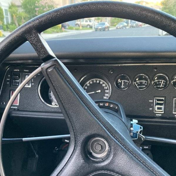

So I thought I'd share how I did not know how far to turn the tie rods to make a difference. It was originally to the left off center at about -15 degrees from the top. I turned each tie rod two full turns differently based on the video, and went way too far to the right. In time I got it but thought I’d share how easy it is to get things out of whack! This was my first test drive in the picture below. I put them back and it only took 1/4 of a turn on each side (in different directions as per the video), checked toe and made a few small adjustments and back to center.
