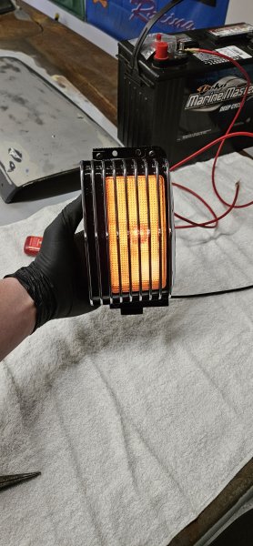

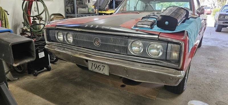

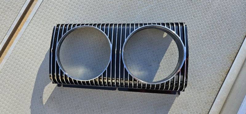

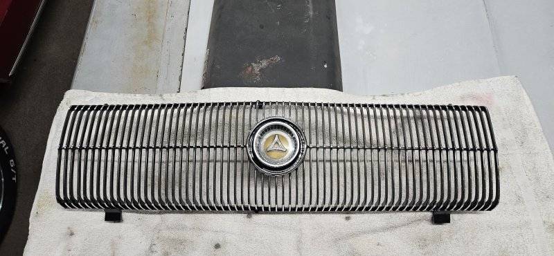

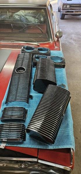

This weekends project was to tackle the full grille and headlight bucket restoration for my 66 Charger. I read a couple threads on this subject before attempting the process myself. VERY VERY tedious and time consuming but well worth it in the end. Fingers crossed it holds up.

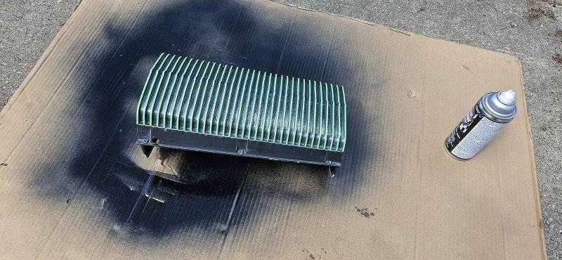

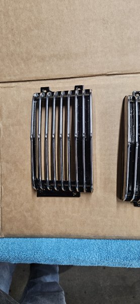

1.Cleaned up all the parts before hand. 2.Took a scuff pad to all the areas previously painted black from the factory. 3.Ran all of the chrome edges through the buffing wheel. 4.Cleaned all the parts again to be ready for paint. 5.Ended up using both methods of taping and lacquer on a cloth to clean up the chrome after painting. Each method has its benefits. Taping was easiest on the buckets and grille but not the easiest around the headlight openings. 2 coats of etch prime and 2 coats on paint over top. Came back after an hour or so of baking in the sun with a Q-tip dipped in lacquer to clean up any missed spot or over spray.

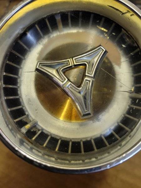

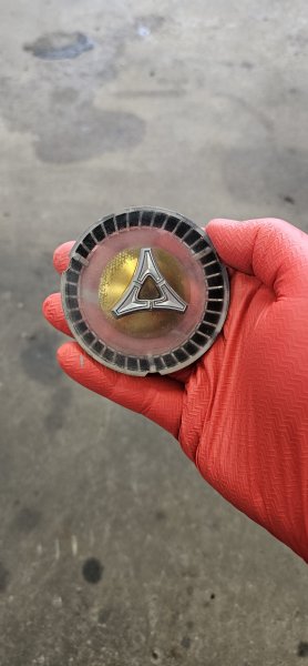

For argument or debate conversation the grille medallion definitely was gold from the factory on this 66

Very nice!! Whatever time it takes is well worth it. Nicest grill out there. Now, the fun part is adjusting and shimming to get everything nicely aligned. That is what will make your car stand out against the next one. It's a patience deal. Some holes may need to be slotted a bit.
And the center medallion... I always believed there was gold ones adamantly.. but they were red, then faded.

I was never sure what the believe either but I believe there was a run of gold emblems. Maybe Early Ones??? Who knows. I do not believe this was ever red before just doesn't seem like it I guess. Because on the other hand the emblem on my 67 is very clearly red that has faded some over time

Here's one that I thought was gold.. but if you spin it in the right light you can see red tones ( from shadow by the fratzog I assume)

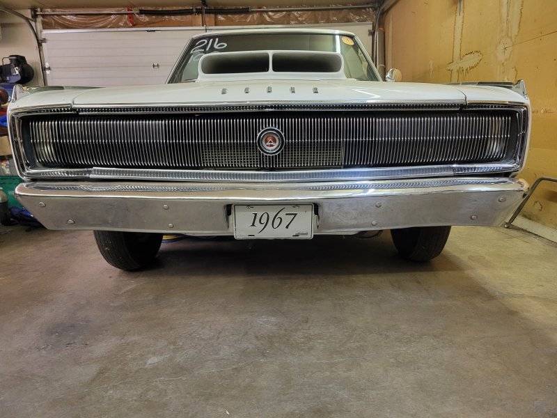

Waiting for the new grille and bucket hardware kit to finish the buckets. Decided to stay with the gold emblem. Understand factory was more than likely red but this should go nicely with the ZZ1 paint
It looks to me like the red was applied over gold sorta like a candy paint. Red pigments don't fare well in the sunlight. I painted mine gold on purpose .

Same as the hood ornament on my '66 Belvedere II...318 call-out looked gold/ tan when I got the car. My uncle (original owner) said it started life red, but faded in it's 1st couple years of ownership. The repop I replaced it with came in red. They likely used the same metal (foil) decal material in your grille medallion as my hood ornament.

I have a great good looking gold one. Would like to see your finished front grille in place.

I did the same to mine but have yet to put it back together. My medallion at first looked gold but the edges were ever so lightly red. I think they were painted candy/Translucent red with a gold background to make it metallic. Red paint does not hold up to sunlight the photons of sunlight end up stripping the red away. How many red cars have you seen with horribly faded paint? This is because the color that's most susceptible to fading in the sunlight is red. This is especially true of intense red colors which may fade even faster. My 2 cents.
