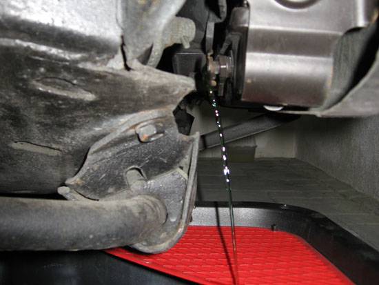

@74sundance: It´s not only the rear holes in my car ! Every single hole ends in the water jackets ! If you loose a bolt it always looks like that (without the boat ! :)! ):

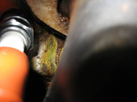

On this picture you can see the problem with the green coolant coming from the header screw hole...running around my sparkplug all the way down to the oil pan.

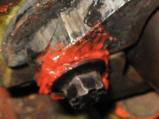

This is what I tried; RTV and something we call Teflonband in Germany.
I wrapped the Teflon around the bolt...
Put the RTV around...
screw it in .....and here we are....
Now I wait some more days...refill the coolant and give it a try !
