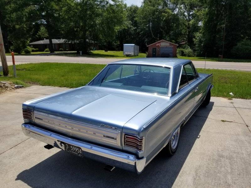

I stayed with a built 727, for the reason you stated. I like the stock appearance on my 66 Satellite.
I will add a gear vendor OD, at a later date. For now the stock 6.1 still gets 20 mpg on the road.
