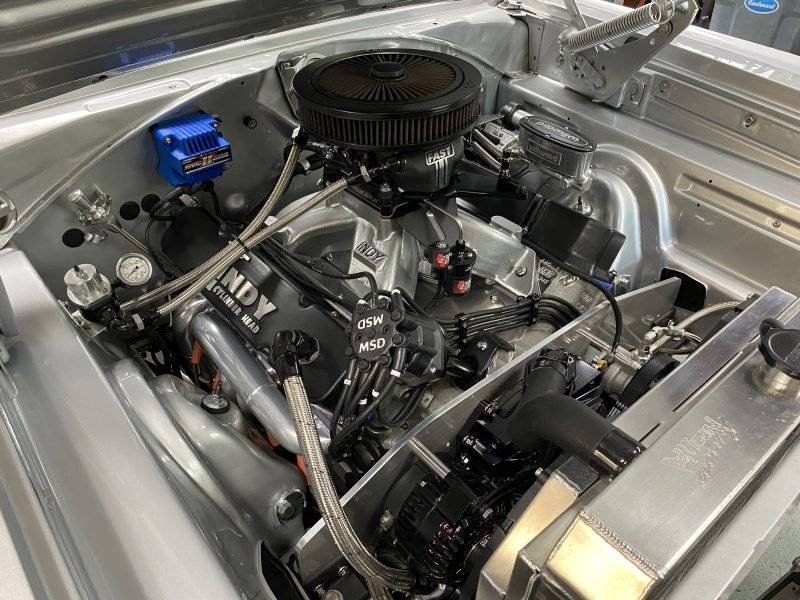

Hey Guys, I’m hoping someone can talk me off the ledge right now. Finally got the 572 INDy Max installed and running but I here is a really bad vibration that start around 2,000 and gets worse to 3,000 then starts to get better but never really goes away.
Short block was built by INDY the rest I assembled.
Callie’s Compstar Crank and Rods
Diamond Pistons
ATI balancer
Comp Solid Roller LowShock 285/[email protected] .711/.721 112 LSA installed at 109
440-1. 345cnc heads TD rockers
Not sure what to do at this point I’m supposed to be leaving for dragweek in 2 weeks but I can’t drive it like this for that long.

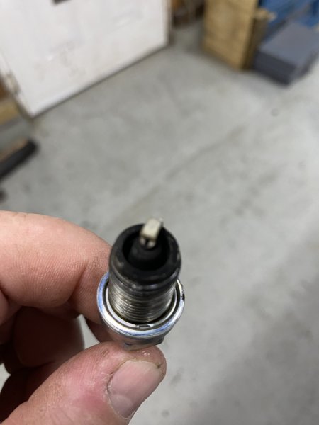

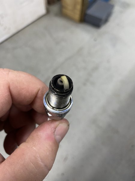

Could a dead cylinder create a vibration? Pulled 6 of the 8 and most where fouled but that’s probably from before it was tuned and running pig rich. The straps are clean but porcelain and threads are black. I’m going to get the other 2 out and check those. I’m really hoping it’s a dead cylinder or something like that. 4-7 swap got me thinking though (I thought that was only a sbf thing)it’s a Frank Lupo Concerter but is not the one that was in there before so that’s a question too.
Something else weird the header coating is fried on cylinders 3-7-4 4 being the worst going down a ways.
Could intake be sucking air/oil from valley? Black plugs from oil and lean from sucking air.

I think the Burnt header coating is from initial start up. Had the MSD box set up for Hall effect instead of ECU so was pulling tons of timing. Took awhile to figure that out. Plugs are black soot no oil. Also from initial start up pig fat. I will replace plugs tomorrow and call Kenny at Indy to see if he has any ideas. I don’t think it’s a 4-7 swap cam. I was thinking to check rotor phasing. I set it a 35degs on the balancer lined up hall effect trigger but who knows maybe it firing the next cylinder out of turn. Could be why 4-3 tubes are burnt they are next to each other in firing order. I have a cap with a hole in it to check with light. I will do this Tomorrow. I was also thinking of sliding the converter back but yea no starter ring. Anyone think is even possible for the converter to be out of balance? I traded my old one to Frank and got a credit for this one needed billet hub and lower stall…I wish i keeper the old one at least I knew that one was good.

I ran this motor with only a partial tune basically just idle in order to get to Carlisle. It was pig fat and wouldn’t do much more than idle but it got me from trailer to show space and back. That’s when the plugs got so bad. When I got back home I set up a tuning session with Rich from fast man efi and went through the whole thing.
Starts and idles great but as RPM increases I get a weird vibration that has nothing to do with drive train the car doesn’t even have to be moving I can feel it standing next to the fender giving throttle by hand.
The motor itself when I put my hand on it doesn’t really seem to be vibrating as badly as the car feels it. I think the motor plate is exaggerating the symptoms into the frame. It will shake my fenders and vibrate the center console.
