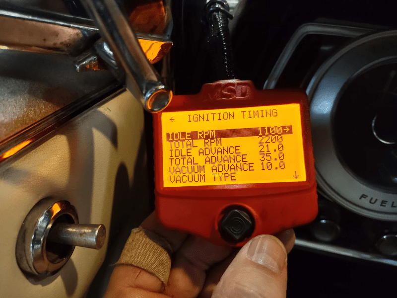

Here's how mine is set on the MSD. The idle speed is not set at 1100 it's set to 675. But the advance curve starts at 1100.

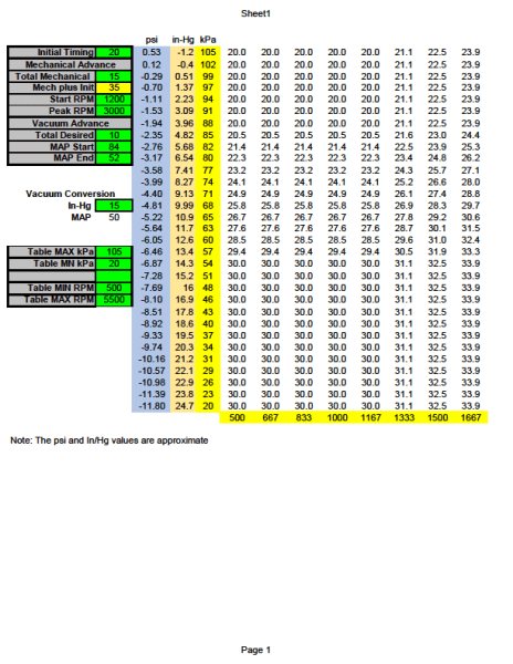

Are you controlling timing with the EFI (Hyperspark distributor etc), and are you using the tuning software on a PC? If so, I have a spreadsheet that you can use to input all your desired timing values at every point in the RPM curve and then copy/paste into your Holley EFI software.
PM me your email address and I will send you the file.
*Note--you do need to know what you're doing when manually manipulating your GCFs...I make no guarantees or promises!
The file I have has worked wonders for my crew though. Wayyy better than the "wizard" or handheld interface timing setup values.

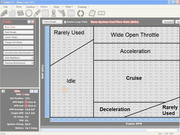

The image below is of a base fuel table but your timing will obviously be inferred from it. The blocked out areas are not set in stone nor will they be the same for every engine but it's a good starting point. There will be overlap between most areas too so you will have to drive the car, see what it wants and make adjustments as needed.
Be aware that as the ECU learns, the 'learn table' will fill up with values. If the learn table values are consistently larger in a particular area (+/- say a value of 15) then you need to make adjustments to your base tables to get the compensation percentages in line. When building your air/fuel ratio table it's probably a good idea to use these areas as a guide as well, it's all related. If/when the car is running good, the learn table values will be single digits and the closer to 0 the better. The table will never be all zeros though as there will always be some level of compensation due to weather, temps, etc.
Applying these concepts through the software is where 'the magic happens' and is precisely why you want to create your own fuel and timing tables. Using someone else's 'known good' tune is fine and will provide a place to start but it may not be a perfect fit for your particular application. I maintain that creating your own tables is a worthwhile exercise when learning how to navigate the software. Active involvement with the tuning process is what separates the OK running cars from the razor sharp ones. Custom tailoring everything to your specific application is what makes the investment worthwhile. A lot of guys don't go through that process and probably don't even know it's something they could be doing.
What I will say is that before you start doing anything make sure the X/Y axes 'make sense' and are the same for both the fuel and timing.

I'm not sure if this was in reference to my post, but the spreadsheet file I mentioned is not my nor anyone else's tune but rather a customizable Excel sheet with the proper formulas that can calculate and set the table values according to the data you enter.
You will enter your known and/or desired values at the left, and the program will fill in the table and be close to ideal BUT you will have to verify and customize the table values according to your particular engine build and vacuum/kPa readings under the various driving conditions...
This a rudimentary partial screenshot of what it looks like:
Guess I misunderstood the Excel file idea but unless I'm missing something, entering timing values in Excel and then copy/pasting them into the Holley software seems like an unnecessary step since that's exactly what the Holley software does when you create a new table. You have to input the data at some point so might as well just do it in the Holley program. That's how I did it and it worked fine plus it helped me learn how to use the software.
