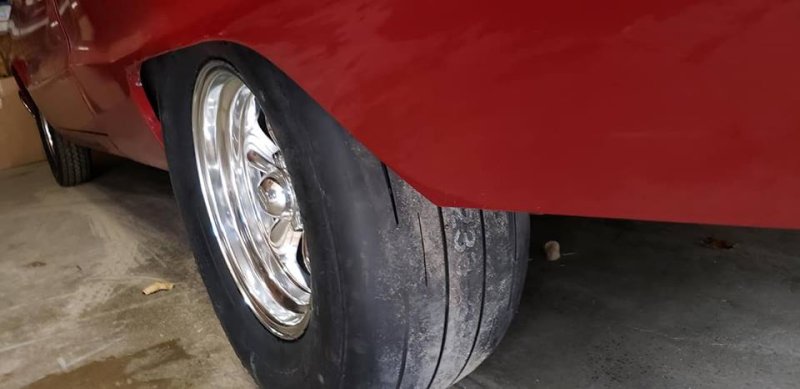

It's been a while but thought I should post my results. 26x8.5-15 Hoosier slicks mounted on 8.5 wide rims with 4.5 backspacing will fit. The outside sidewall looks like it would be real close to rubbing if the suspension was fully compressed, but if the suspension travels that far when the slicks are on I've got way more serious things to worry about.
