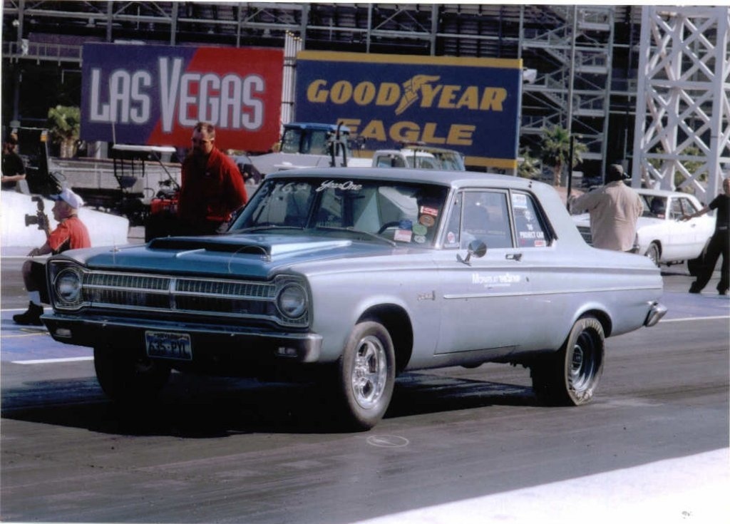

I built this car in 2003 451 stroker with a Tremec 5 speed then later with a Manual shift 727. 8 3/4 with 4.10 Sure Grip. Drove it 30K and drag raced it too with slicks. If you have a proper gear set up your 8 3/4 should do just fine.But anything mechanical can break...The photo was when it was a stick car.When it was a stick it had 3.73 gears.
