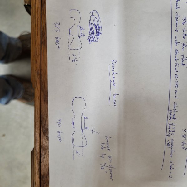

How much space did the PG Classics baseplate save you? Thanks

Here is my scribbling from the manifolds I had with their measured heights and how they compare to a stock 383 4 barrel peice. Looks like I measured that the 440 base dropped the aircleaner lid 11/16". Still not enough to fit the RPM intake if that's what you were wondering.

Ahhh, I missed that little tidbit from the first post that you stated you have an R/T. So it already has a 440 baseplate. And you are dealing with RB intakes. So everything I posted unfortunately does you no good.....

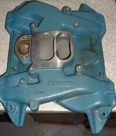

This Mopar M1 aluminum RB intake manifold is the only one that is the stock height, it has an operating range from idle to 5800 rpm part# P4529118
Last produced late 1990s but I have seen used ones for sale.
