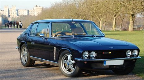

Possibly a Jensen C-V8 from between 1962-66 ??? The owner called it an Interceptor - but that puts the car at 1950-56
My buddy Cliff had this car roll into his shop late last week for some minor work. I think this is an import from quite some time back, and the owner is getting it ready for inspection to register for on-road use here. Talk about leaving it late - all the rules have changed again recently, and bringing in cars to NZ is not as easy as it was 20 years ago.
Anyway, the frost plugs need to be replaced as whoever tried it last time didn't install them correctly.
Also looking for confirmation of what the car actually is....the engine size - we think 383, but it could be a 361. Also uncertain of the year. The owner appears to be a bit foggy as to what he has also. Cliff is going to get the block casting numbers for me and hopefully a tag number.

NOT an Interceptor. Yes, appears to be a CV8; should have a 361 unless its a] not original or b] one of the very late ones that could have had a 383. Best bet is a 361. Production date should be somewhere on a chassis plate I would think.

Thanks @guy gadbois - I was thinking 361 also..... looks like I need to pace an order for exhaust manifold gaskets also - none in NZ.

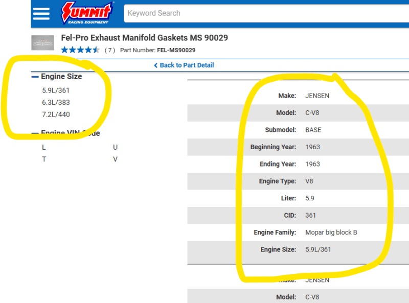

I assume that the 440 and 361 are different exhaust gaskets?
I believe so, but double check...
It just occurred to me to check Summit - for applications....
...and if we're lucky, it might turn out to be a 383. :thumbsup:

Theoretically, if a 361, it should have a two barrel, 383 probably a four barrel. I would guess the 361. Huge motors aren't a real draw in England, gas prices and taxes discouraged them.
Definitely not an Interceptor. Interceptors signature feature is a giant back window that makes a gen 1 barracuda look small. 383 or 440 in an interceptor.
Interceptor was an early 70s offering, if I remember right.
Edit: C V8 from 62-66, early with 361, 64-66 with 383, total production for four years, 499 cars.

The block casting confirms the engine is a 361. The owner now says the engine was bored out to 6.2 litre from 5.9....making it close to 370 ci.
Talking with Cliff, he says he saw an episode of 'Wheeler Dealers' on TV where they bought a Jensen and actually went to the factory to find parts they needed. Turns out Jensen keep all records from every car produced, and they are happy to share that information. Only catch is that they retain the original documentation - they will however give copies out to owners.
Armed with that info, we'll send the owner on a hunt to get copies of the documents direct from the horse's mouth. :rolleyes: I also told Cliff to look for numbers and markings on the top pad, the left side of the block above the pan gasket, and also the transmission numbers.

Exhaust gasket is the same...361 is a big block
NOT arguing Mr Dutchrebuild, but my fuzzy memory says that the early 'smaller' engines had smaller ports than the later performance engines [?] Are they the same size and shape from the early '350' thru the 440 6BBL? If so, I'll stick that factoid into the memory banks and see how long it sticks... :)

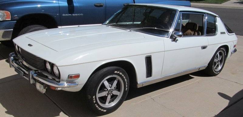

Yes, a 1973. No louvers in the hood. The white car attached.
I usually see the louvered hoods on 1974+
A few months ago, I was moving the Jensen out of the garage, and the left side front brake hose blew out, so even more leaks and things to fix on the car.
