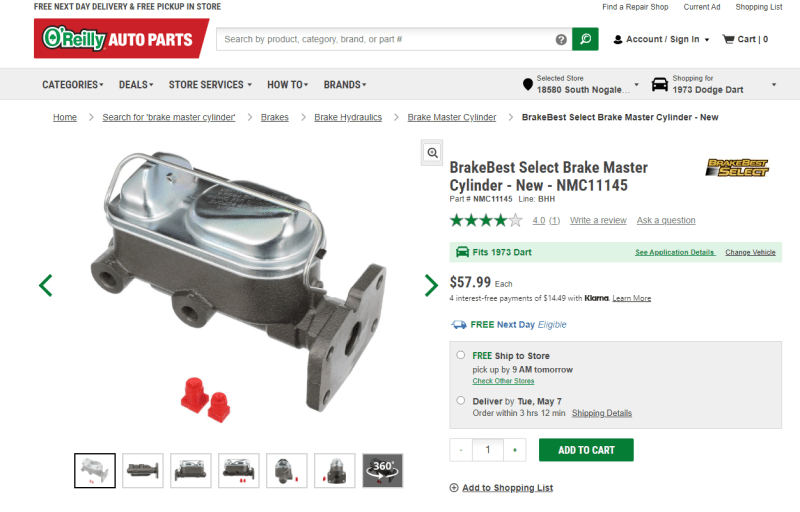

That display picture for the master doesn't even show the bolt holes to hold the boot over the pushrod. Do you remember doing your install? Did it have the provision for the retainer and push rod boot? Did your push rod snap into place and stay locked in?

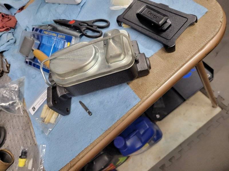

No boot or provision for the boot on the back side. But yes the internal piston has the groove for the retainer to snap into
By application the one I linked above is for Power disc brakes,
This one is listed for manual disc brakes. BUT it has the larger piston / bore size. Which is not ideal for manual disc brake converted car. At least so I am told.

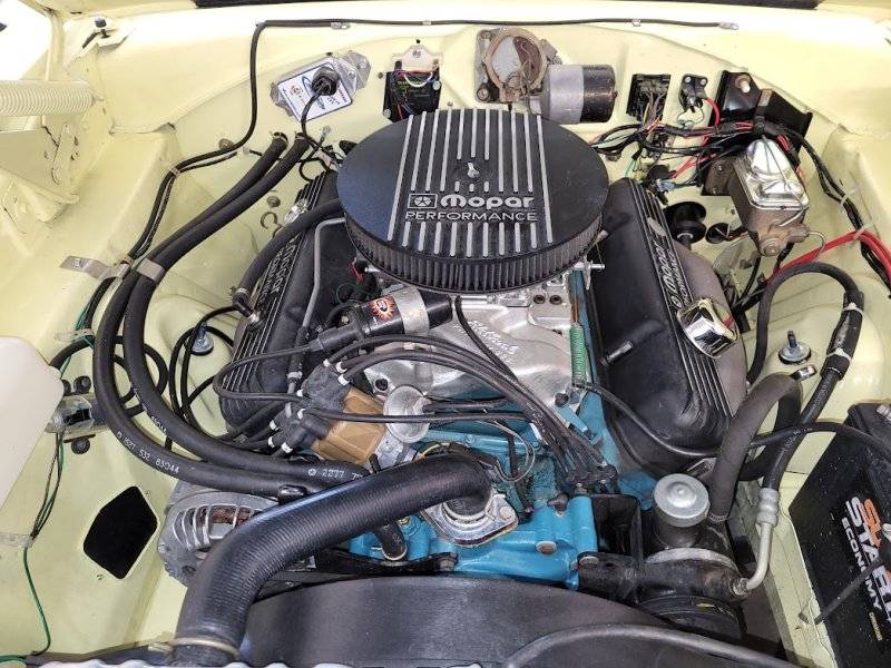

This is in my Dart. Has the groove for locking the pushrod . You can use a piece of vacuum hose to lock the pushrod in if your old one is bad.
