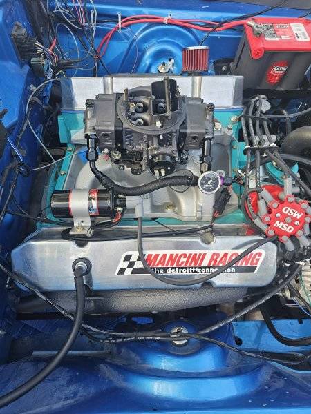

1967 440hp
-All new engine wire harness for Big Block with points.
-New MSD ready to run distributor
-Blaster 2(black) coil
-Msd plug wires
First start ever for breaking in the Cam.
Kicked right over. Turned off for water leak.
Kicked right over again... turned off for fuel leak(30 mintue fix with carb)
Now it doesn't kick over at all...NO SPARK!
I checked with inline plug wire tool.
I have power to the + side of the coil during crank and run position.
I put my hand on the coil..Super Hott!!!

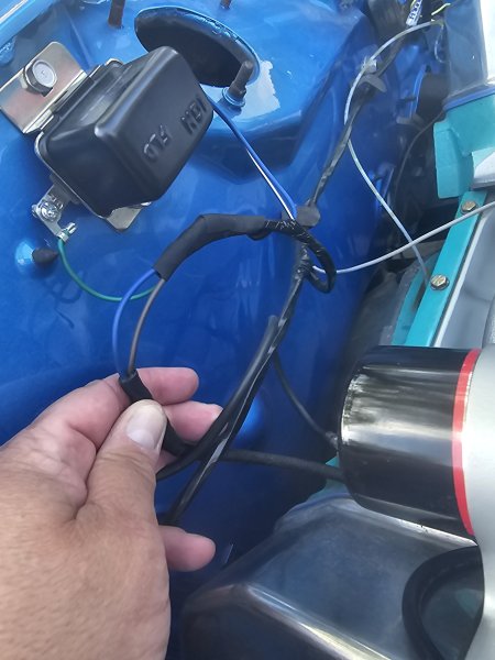

Brown/Blue wires(main harness) tied together ,the little red wire going to + coil, and the orange to the negative side.
No Ballist Resistor.
What the "H" is going on??
Please help I want to fire this thing up!
Here's what I'm looking at.

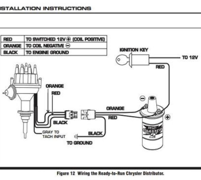

Normally msd stuff goes orange> coil+, black > coil - and red is the power trigger.
Edit; looks like you are correct on the wiring from what I could see
Black wire to ground

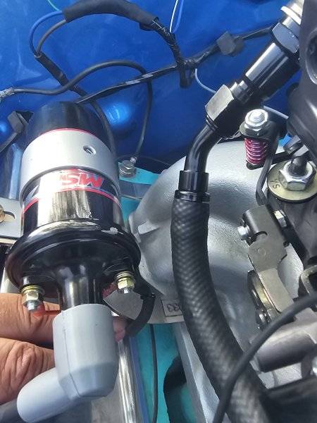

Black wire is grounded to the block
Red wire is mounted directly onto the plus post along with the brown/Blue wires from main harness.
Did the MSD DISTRIBUTOR SYSTEM AND MSD COIL and the instruction instructions stipulate that no ballast resistor was required or did you just assume that it was not needed? What do the installation instructions say....specifically ? What manufacturers model coil was used? What is model of the MSD Ready to Run distributor. Are the components you selected compatible? Please advise specifics ... can you furnish a diagram for the installation.......

MSD 8387 Chrysler 426-440 Ready-to-Run Distributor

If I zoom in on your coil photo, to me it looks like you have your + and - sides hooked up backwards. It looks like the large black ground wire is hooked up to coil +
Also, don't leave the key on for too long without the engine running.
Also, please let us know or show a photo of where exactly the coil ground cable is connected on the other end. If it's to the head, sometimes this can be a poor ground and cause coil overheating.
