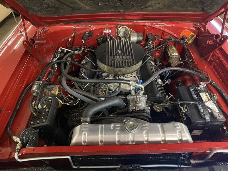

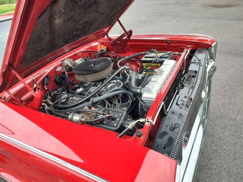

The previous owner on my 66 Charger (383, 4 spd) installed a front disk brake conversion. He used a dual bowl master (looks GM) but no booster. I would like to install a booster.....any suggestion on a good kit to buy that had all the necessary "stuff"....?
First, toss the GM master cylinder. The proper looking Bendix dual diaphragm power booster is being reproduced, and be purchased through most Mopar reproduction parts outlets ( Year One, Classic Industries, etc. ). Pick up a 1967 Charger disc brake ( different than drum brake ) master cylinder at your favourite parts jobber ( O'Reilly, Car Quest, etc. ). You might need a set of '67 disc brake lines from Inline Tube, as well.

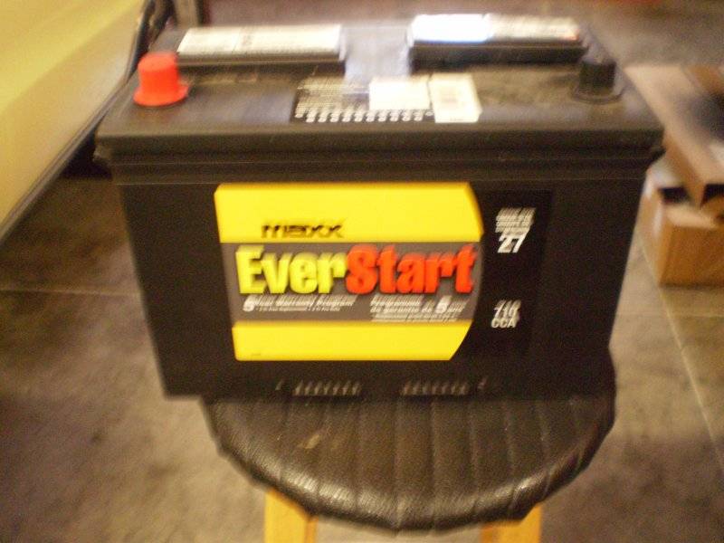

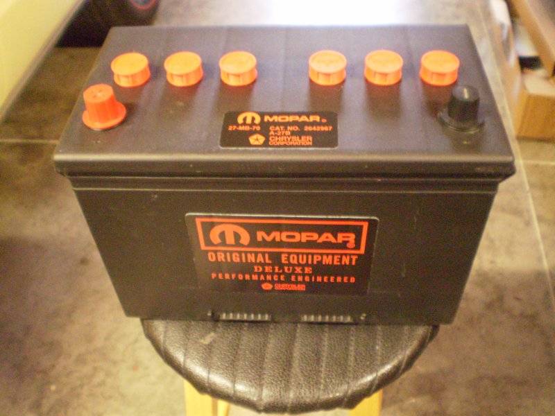

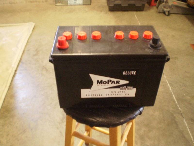

On another topic, here is a little trick for your Walmart battery to dress it up. Look up Weskcar website. Cap and decal kit for $25.00; takes 15 minutes.
Looks like a chrysler disc brake cylinder :thumbsup: might be able to slide a bendix in there like Dave said
