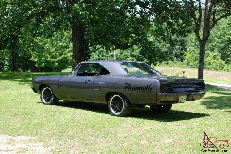

I want the front fenders to be at the top of the tire and the same with the rear fenders. I like a little old school look to the car with staggered wheels and tires.

I don’t think new leaf springs will accomplish what he’s after. he wants the lines to be on the tire. I’ve never even seen a b body that high.
You can order +1", +2", or I believe even a +3" over stock spring set from ESPO and others. I agree though that on a Plymouth B-body, the top of the wheelwell always down into the tire. Dodge has more of an arch in that area.

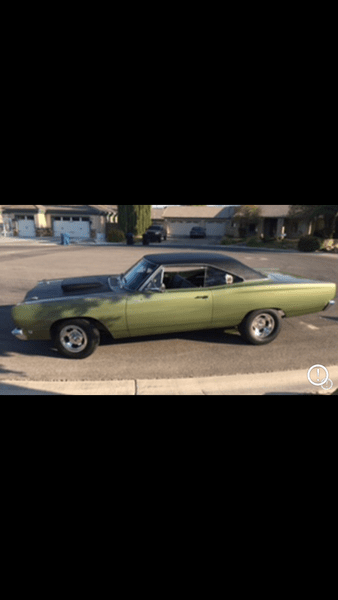

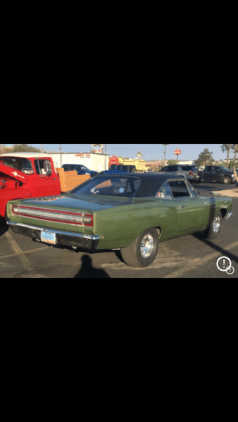

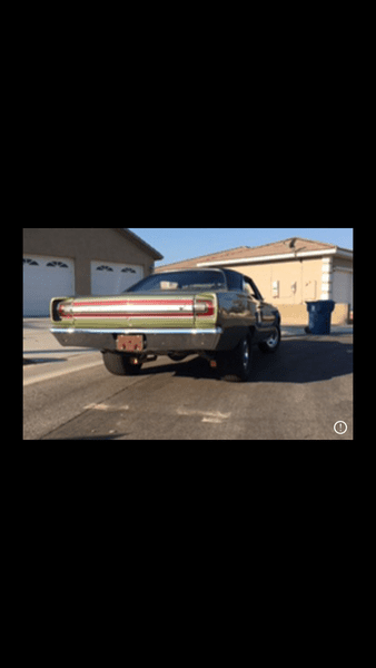

Is this the old school look you’re looking for, I’m running 5 leafs on both sides and factory type shocks with N50-15’s

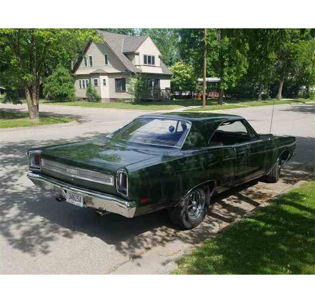

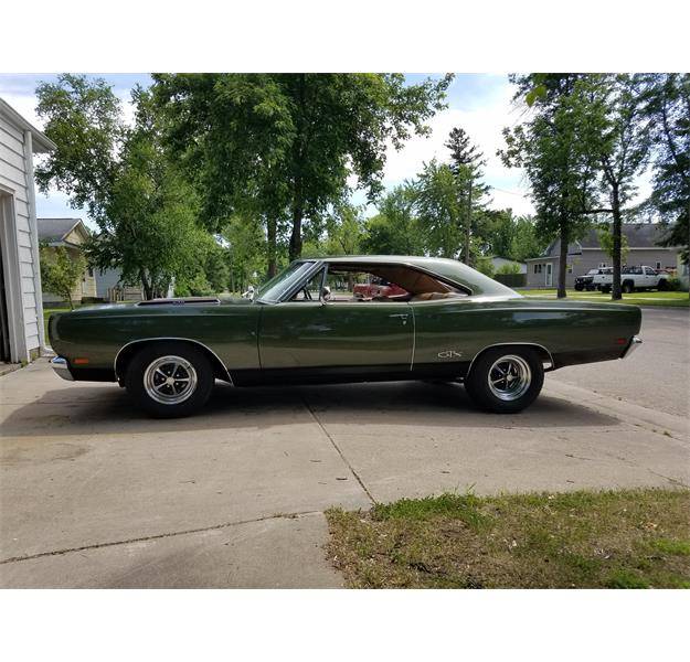

My GTX rear sits a little higher than stock for the "Old school" stance. All done by taller rear tire on 15" rim vs 14" on front. Both are the rally style rim, thus not immediately noticed. Ride is very good.
