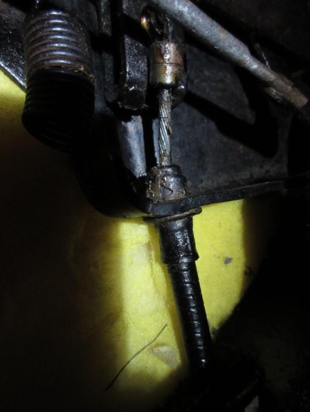

One of the tabs on the original is broke. I've got a new part but how do you get that cable loose so the part can go over it?

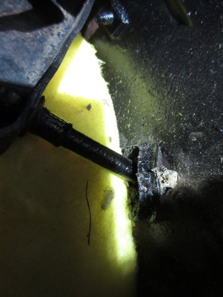

I pried the end piece out of its bracket, but this fastener that holds the cable to the parking brake assembly doesn't want to budge. How does this thing come loose?
It turns out this doesn't snap into place like the cable does on the drum end, although it looks similar. I got a screwdriver under that lip and pried it out enough to get a little prybar under it, then used a little sledgehammer to knock it loose.
With that out, it's clear that DMT's parking brake grommet can't be installed from this end.

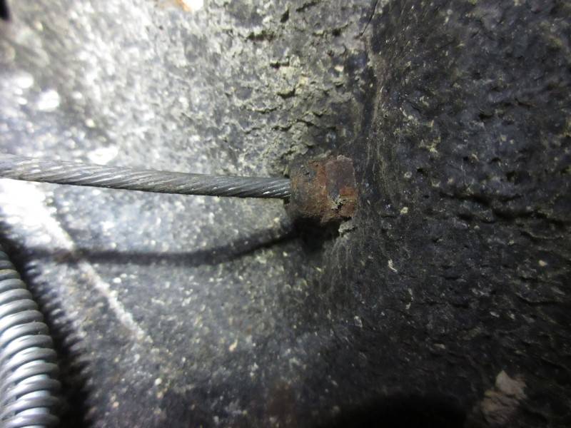

I pulled the other end off of the bracket it goes into, very easy, but there's another fastener attaching the cable to a crossmember -
Clearly the DMT grommet won't be sliding on from this end either.

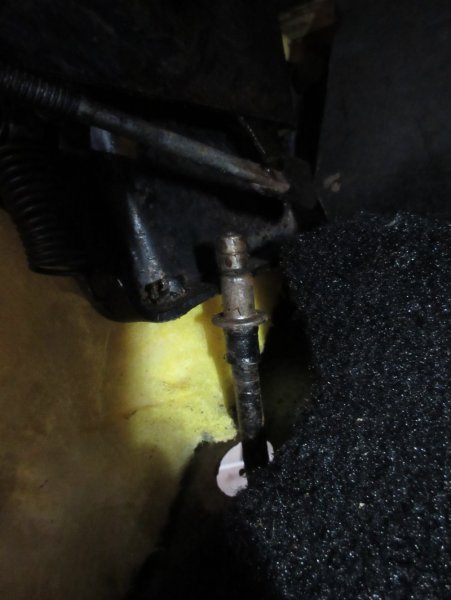

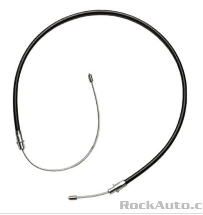

My next thought was that the grommet must be put on the cable when it is manufactured, but here's a new Raybestos cable without a grommet -

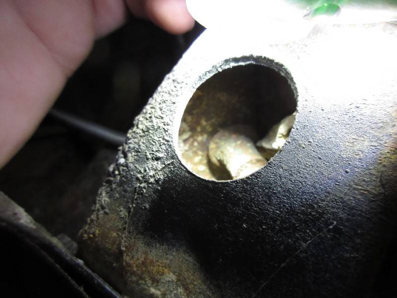

O.K., if the grommet is heated and lubed will it slip over that lip? I can't see any other way to do it. It seems like there would be a metal ring inside, connecting the prongs that snap onto the firewall/fenderwell, but I cut the old one and there wasn't.
