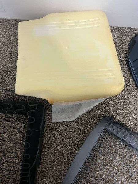

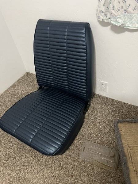

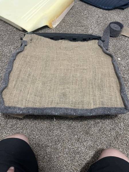

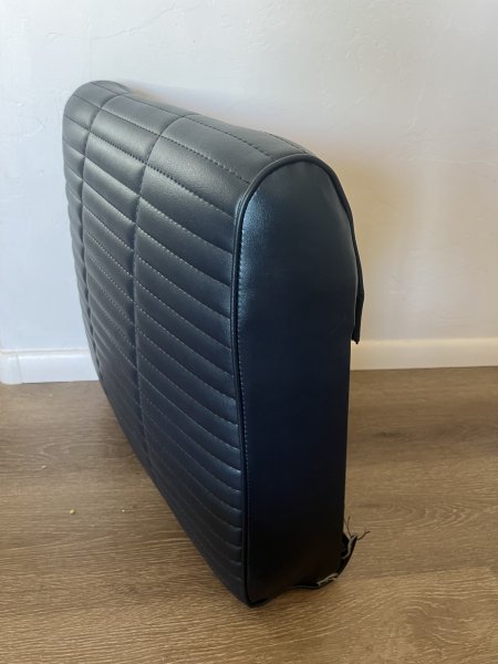

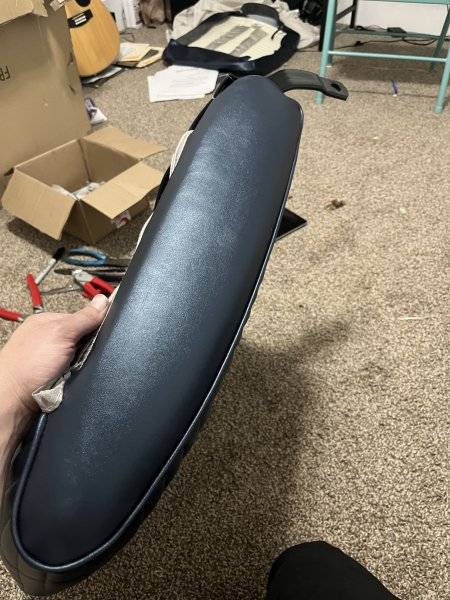

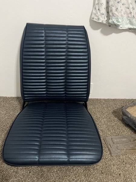

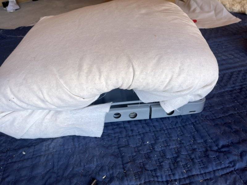

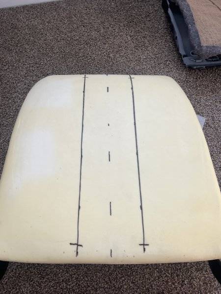

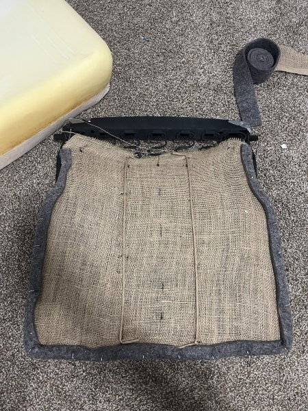

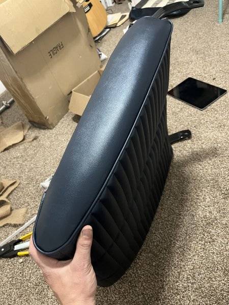

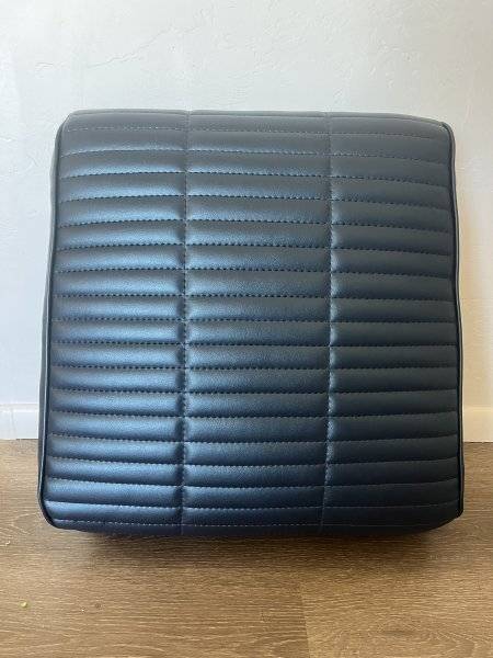

I’ve been working on the seats for a 66 Charger. I just have 3 more frames to cover and I’m done!

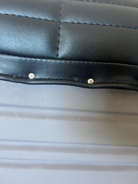

The rear seat back had these metal tabs that kept breaking off, so I used 1/8 rivets as a replacement
