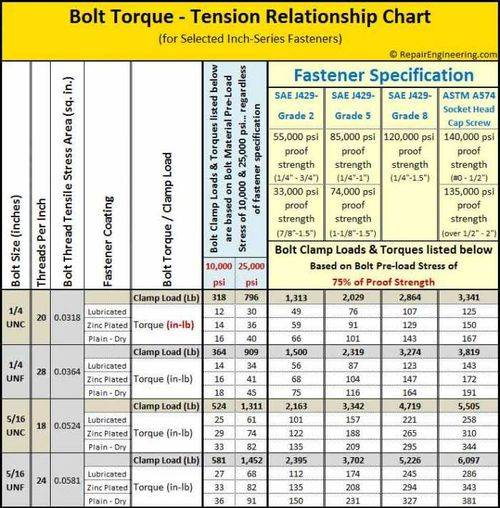

Check the service manual for the proper torque on the nuts. I think it is 45 ft. lbs.
I remember that I wanted to torque it to spec and wasnt comfortable, since the torque was still not reached, but it felt a bit soft, so I stopped. The thread on my U bolts is very fine, with low pitch. presumably thats the reason for the high clamping force with less torque.

45 ft/lbs is with new
hardware. Bare in mind
that once torqued, those
bolts have stretched some.
The standard is 5 ft/lbs over
for bolts that have been in
service. If you don't know
the installed torque value,
you're better off replacing
with new stuff. Also, check
the service manual, as
torqueing wet or dry varies.
Wet is lubed threads and it
does make a difference.
I don't think you've distorted
the axle tubes but thru
normal twisting/rotational
tendencies, have warn a
small groove where the
u-bolt rests. If anything,
I'm guessing your u-bolts
were'nt tight enough.
