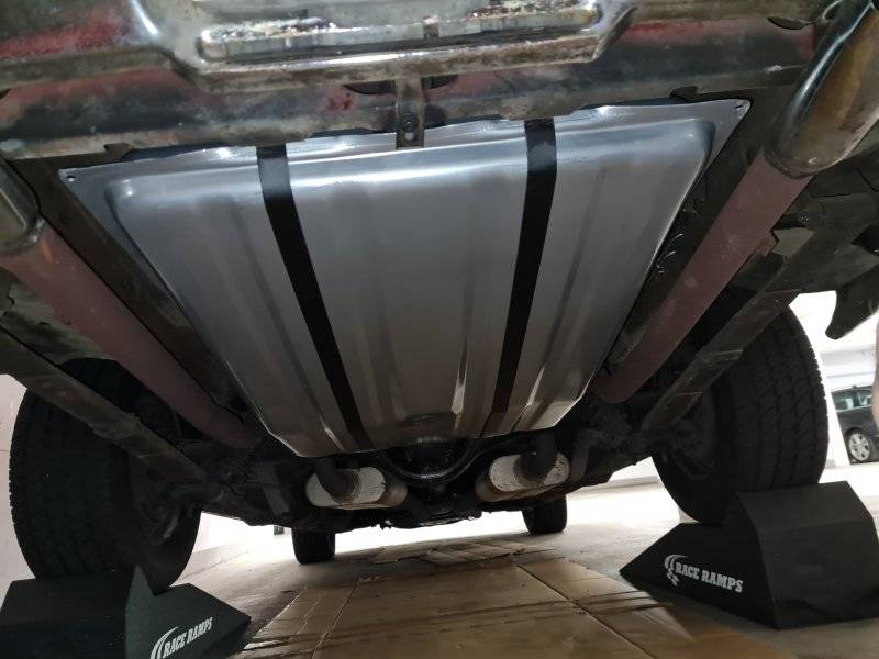

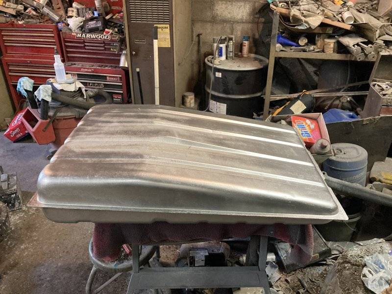

Buy a new Spectra and clear coat it. Did this one 7 years ago...

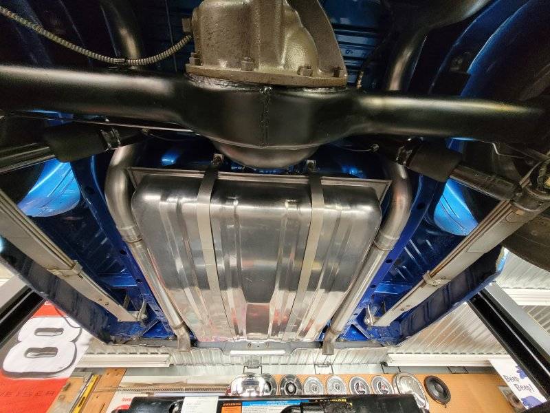

My '70 was unpainted, just the original Ni-Tern coating. My Spectra replacement was the same.

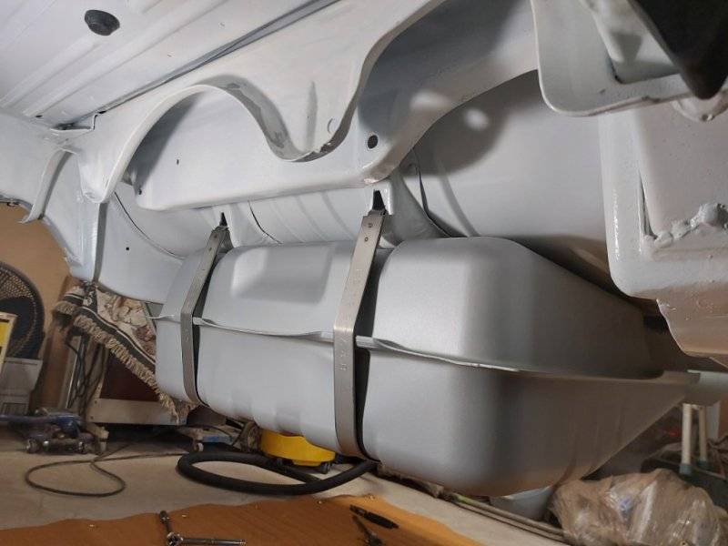

I paint mine with aluminum cast coat looks almost factory

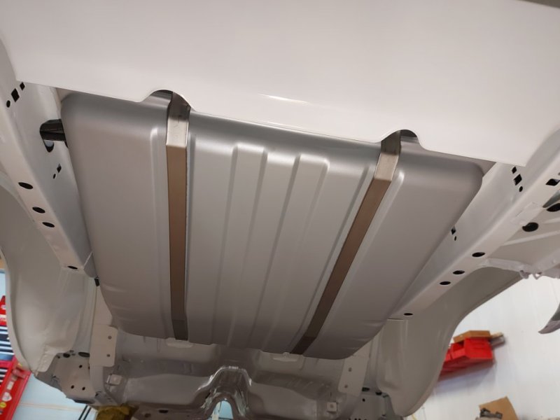

I used cold galvanizing spray paint on mine.
