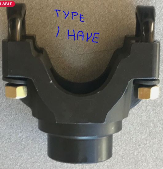

Hi there, hoping I can get some clarification on the different yokes and UJs associated with an 8 3/4. I am having a drive shaft made. I had an 8 3/4 built for me. It is a 849 case, 3.55 gears, sure grip. The guy who built it for me said it had a yoke for a LG 7290 UJ. I showed pictures of the yoke to the guy at the driveshaft shop. They were unsure which UJ should be used because they were used to the yoke for a 7290 having threaded holes and the straps having bolts.
Mine has u bolts. Are both used on a 8 3/4" with 7290 UJs? I offered up a 7290 UJ and the caps seem either a very tight fit or slightly too large and the caps do not extend to the end of the yoke. I have attached a picture of the type I have. Thanks.
None of the factory 8 3/4 yokes had 'U' bolts.......but, it's a good thing to use them and it can be done if you drill out the threads of the factory yokes....but, why not step up to the better yoke instead?
Ubolts are stronger and a lot of after market goes with them

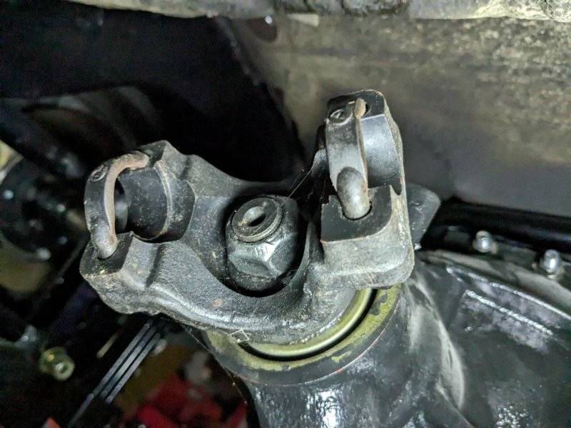

These are pictures of my actual 8 3/4" ... just trying to confirm if it looks like a 7290 should fit.

There's several different type aftermarket & factory style 7290 style yokes
you need to measure it make sure it's the correct size, for a 7290
look it up on the -www- good luck
WOW! There is some super useful information above. Another way to look at it is you can measure what you need (assuming your yoke bolts to your pumpkin). As mentioned, you might not have a “typical” u-joint size, but you’ll find what you need if you know the dimensions you need (length & cap diameter each direction of the u-joint). If you’re building a driveshaft, that REALLY opens up your options. You can pick a u-joint and build the driveshaft to match it

Thanks for all the useful information. I tried offering up a 7290 to the yoke. Not a good fit. As much as the person that built the chunk for me said it was 7290, I believe it may be an odd ball, like 1330. In any event I ordered a new yoke from Quick Performance to take a 1350. This way I will use 1350 on both ends.
