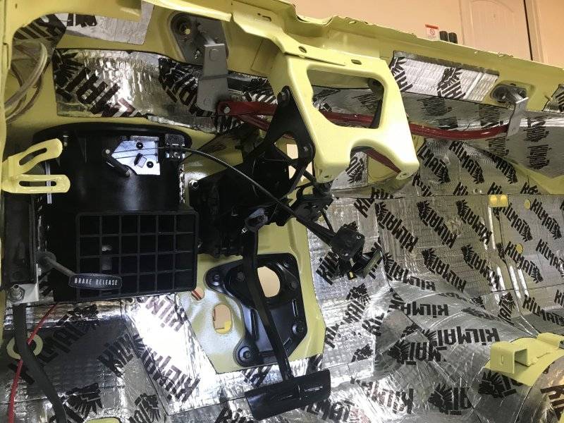

Hi all, 1968 Road Runner, 383 4 speed. Putting it together after getting it back from having rotisserie metal, body and paint done.
I figured out where the other brackets went but not this one and couldn't find the pictures I took when the brackets were removed.
The clips, if I remember correctly, fell down from under the dash when the master cylinder rod was disconnected from the pedal.
Any help would be appreciated, thanks.

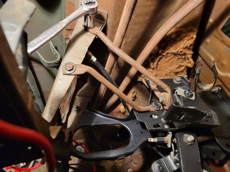

Correct, bracket is for the pedals reinforcement
Clips go on steering column mesh area
Thanks gtx6970, I know it does, I just don't know where in relation to the other two brackets. If someone could share a picture that would help a lot.

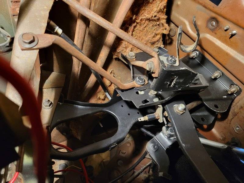

Sort through Justin's sticky in the members restoration section. Fairly certain he showed them...
Look closely, this is before I got rid of the rust.
