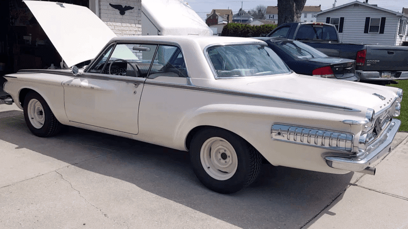

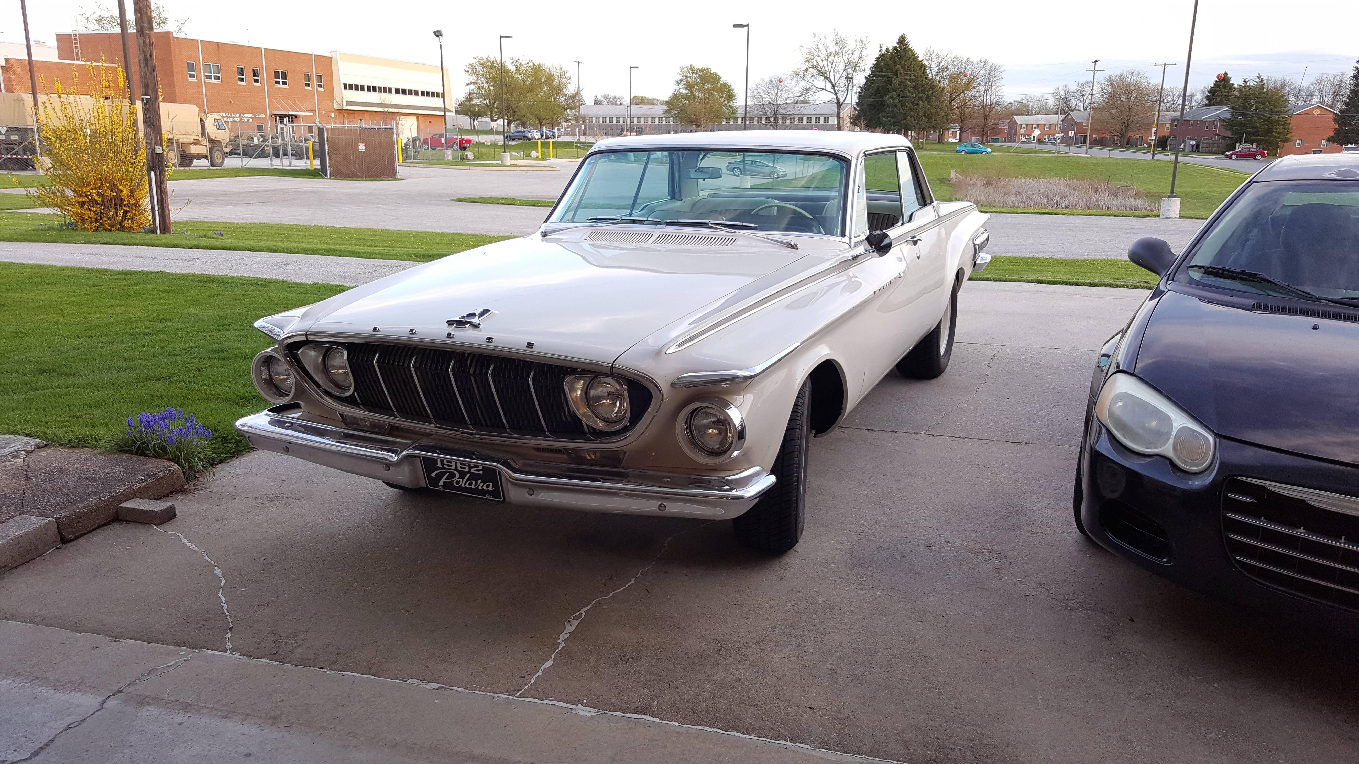

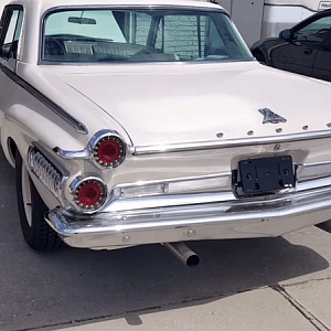

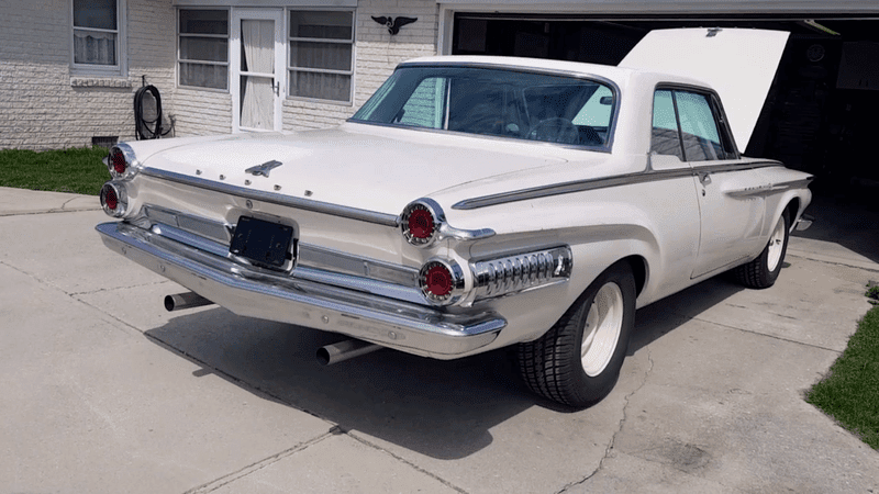

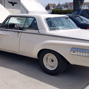

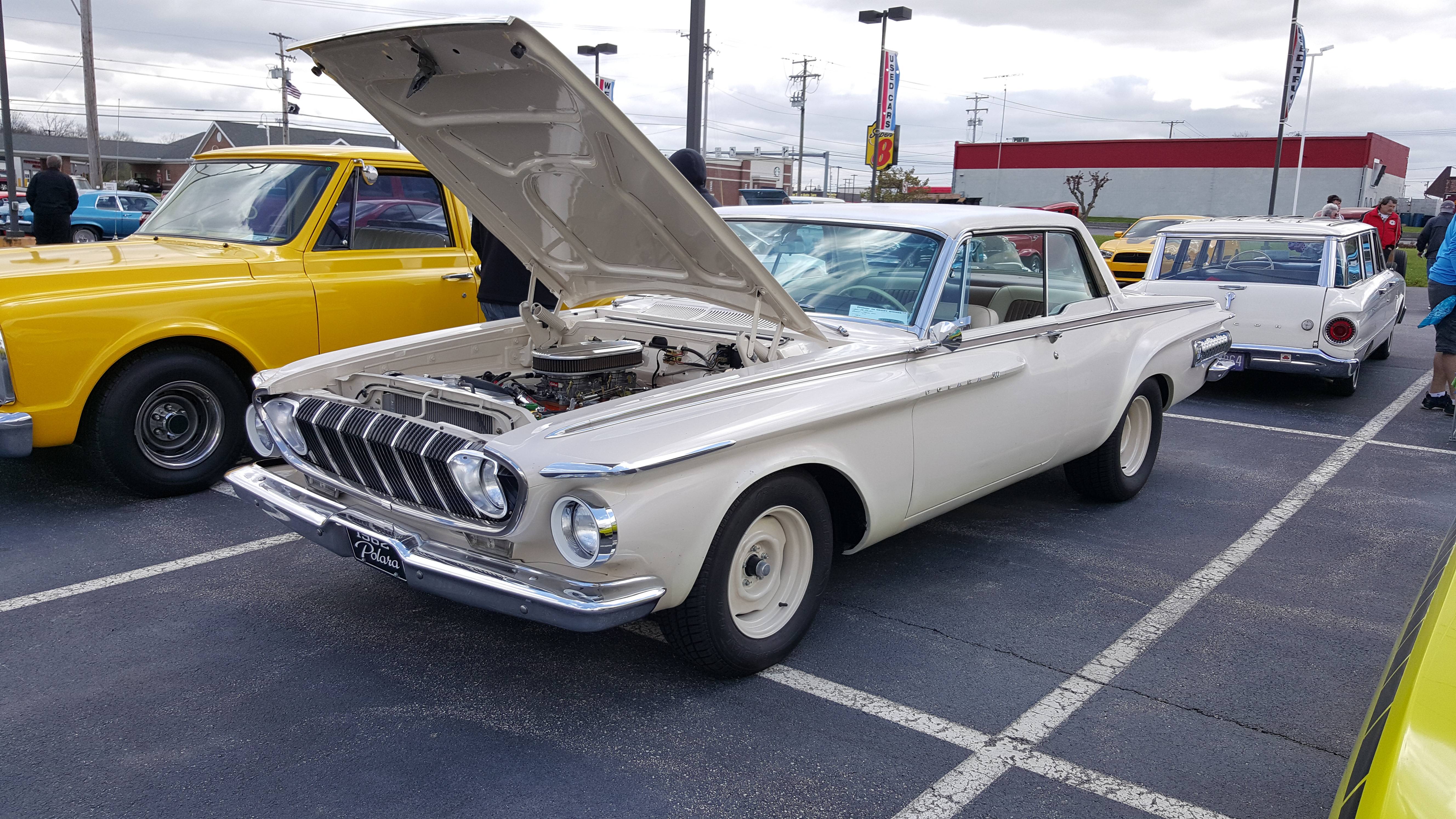

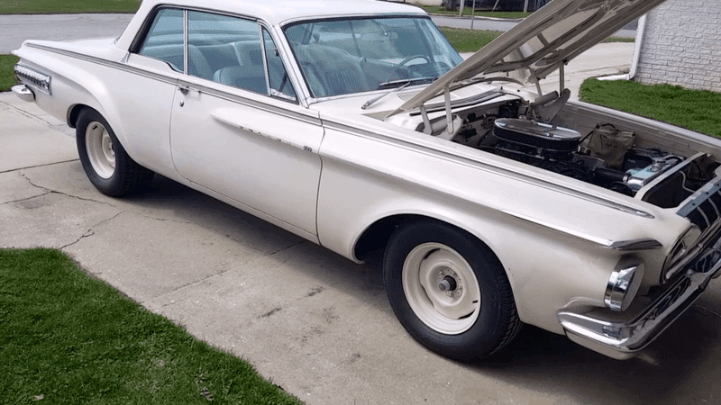

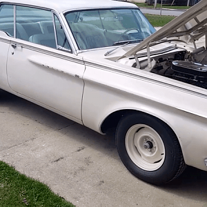

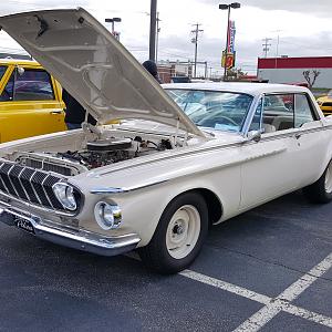

1962 Dodge Polara 500 / On The Road!

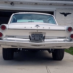

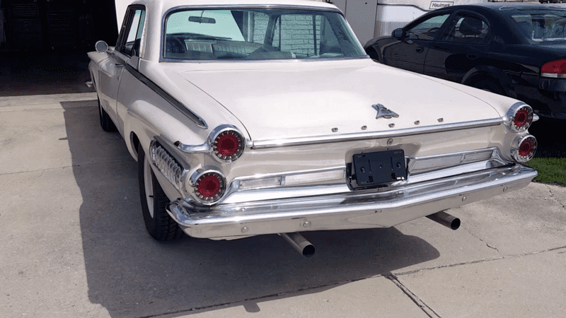

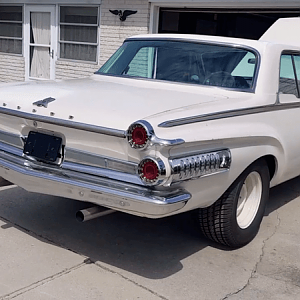

After seven long years, the Polara is finally road worthy.
About this Mopar:
Originally purchased in Sacramento California (John Drew Motors Inc.) Shipped November 4th 1961. Spent most of its life in Oregon.

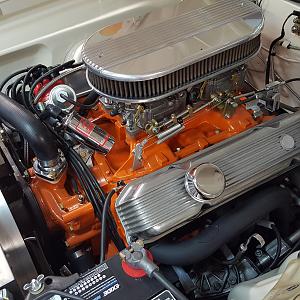

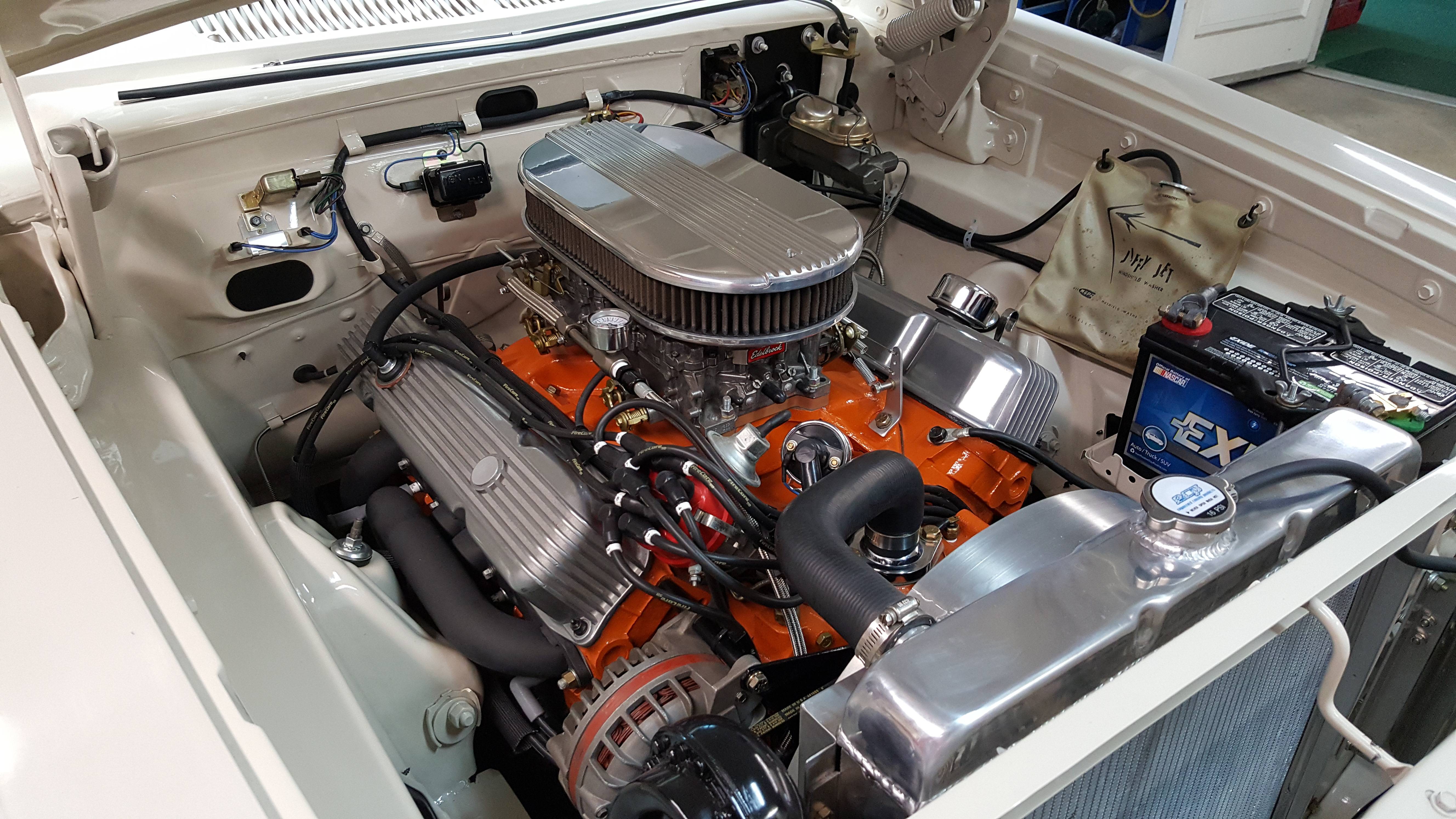

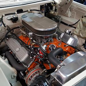

Pulled the original 361 hp engine and replaced it with a fresh 1967 440, .040 TRW flat tops, Sum6401 cam. 452 heads. Dual 600 Eddies with a 50's - 60's cast iron intake. Rebuilt original 727 pushbutton transmission.

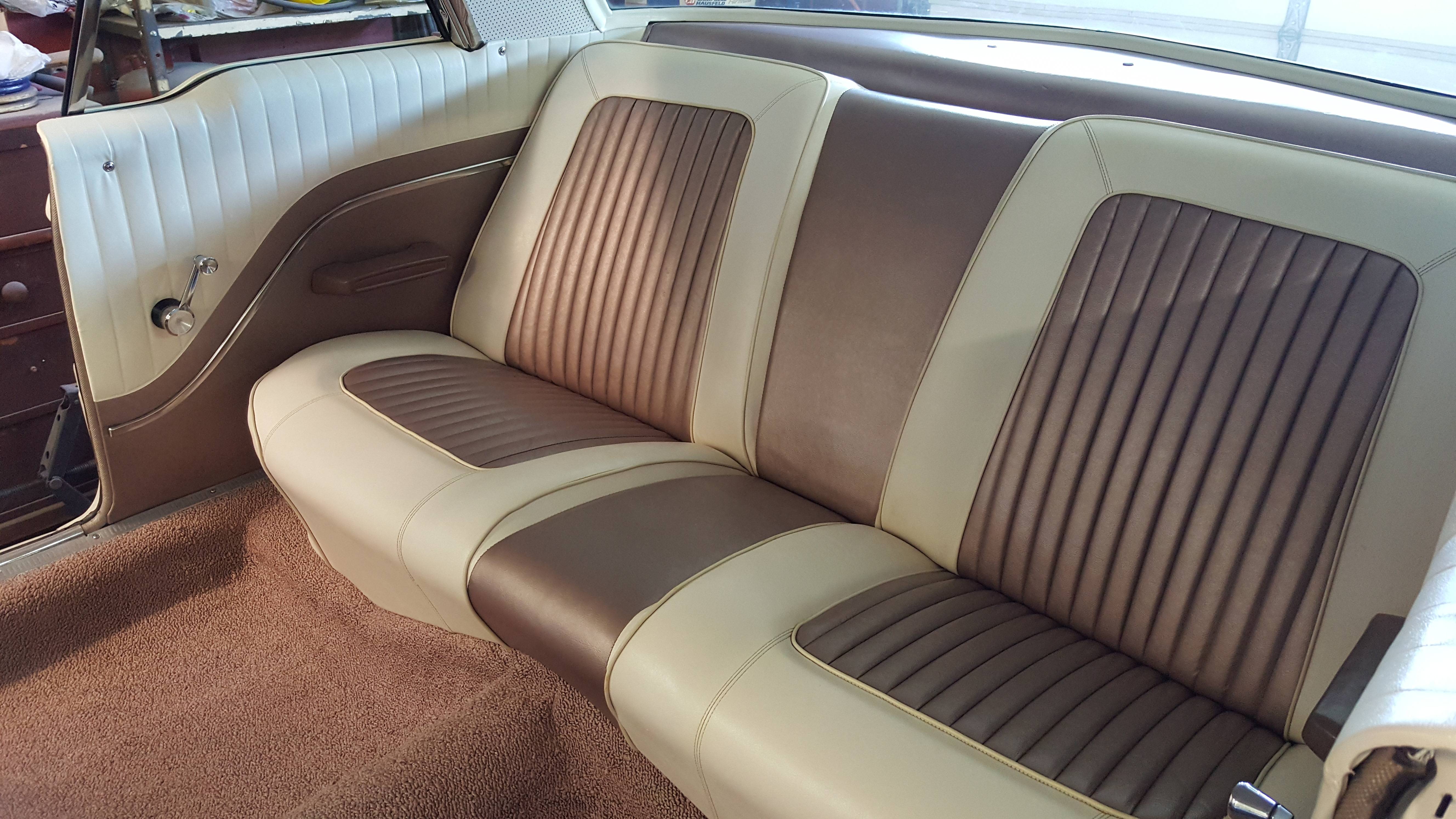

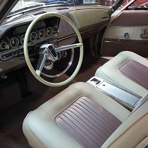

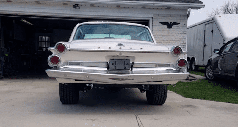

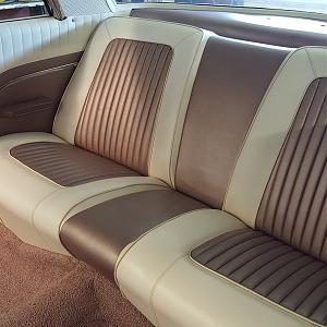

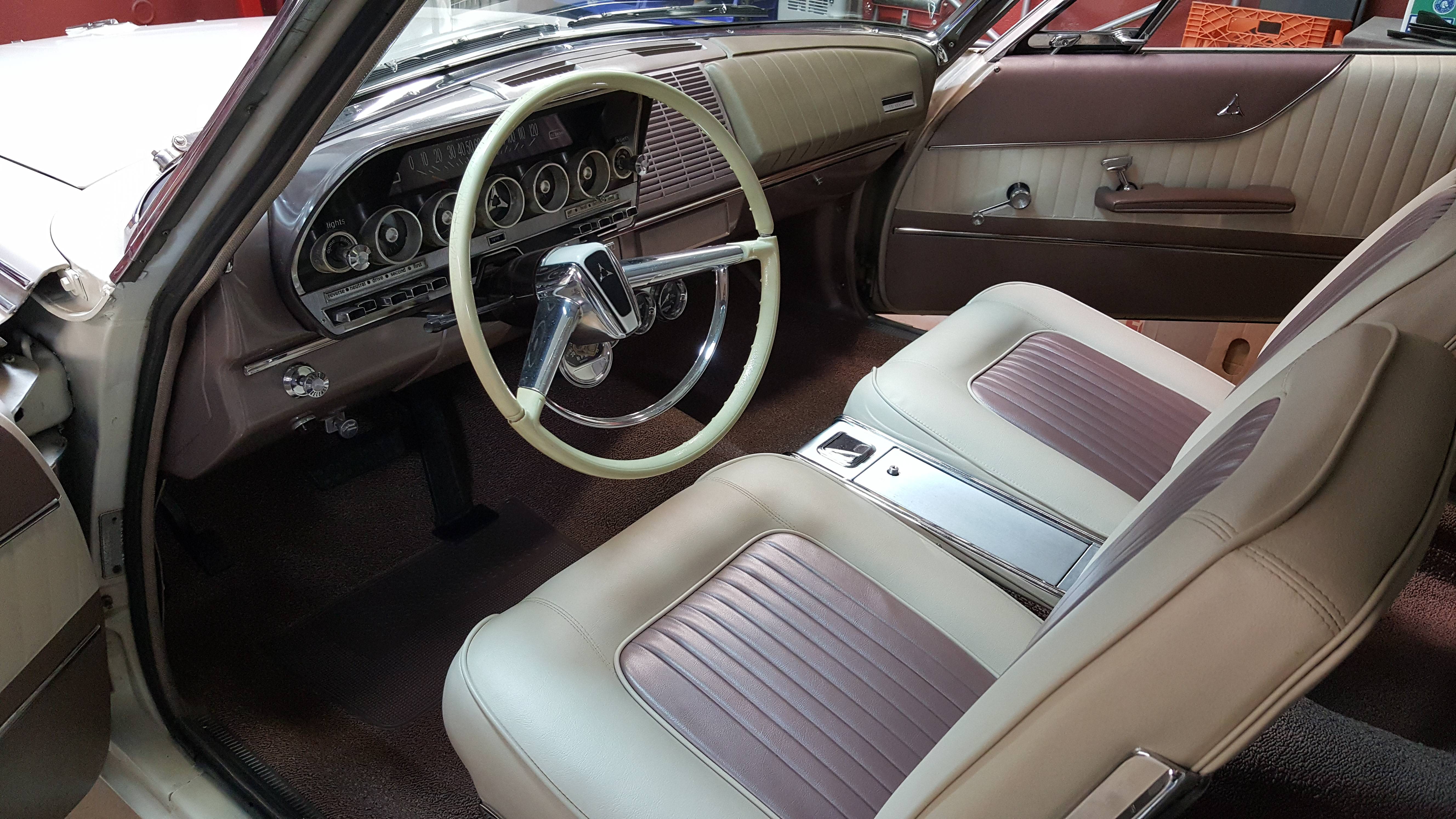

Upgraded rear axles to flanged. Replaced the 2.76 open rear with a 3.23 limited slip. All new brakes, removable drums all around. Doug's Headers with all new 2 1/2" exhaust. New hardboard headliner, new carpet, front seats redone. Rear seat is still original.
Here's my build thread on how it all took place.

Beautiful Polara! Nice work; I'll take it! The seats look nice and comfy to cushion your bottom when mashing the petal! :moparsmiley:
I just today went through your entire build thread and have to say you have done an incredible job in the confines of that home garage! Your attention to detail and patience are virtuous! It is so rewarding bring back something that someone would have been parted out! Your rear end thread was especially interesting to me since I will be doing the same in the near future. Hope to meet you in Carlisle next year! Amazing job on a truly amazing 62!
What a beautiful car.
Love the sound of the motor.
Thanks for the ride along that was great...And to think that I go along anytime I feel like it, that's a bit of heaven.
Thank you for the information on the 1964 Dodge 440 heater/blower fan and motor question.
My hope is that when I finish, mine will look half as good as yours.

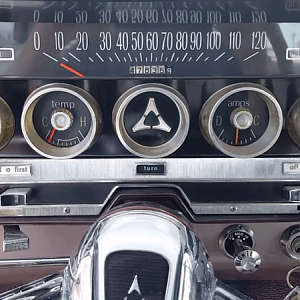

That is a very nice looking Polara! Quite a sleeper with that 440 under the hood now. Looking at the instrument panel it is quite a bit different than my Fury. The colors inside and out sure go together nicely. A super clean engine compartment too. Thanks for telling me to check it out!
