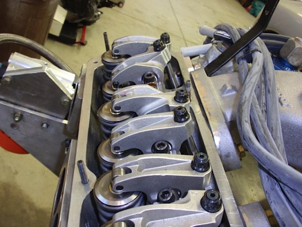

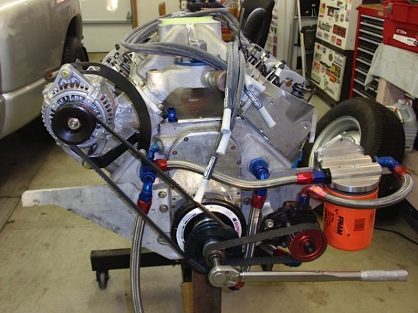

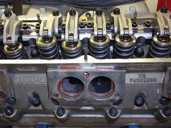

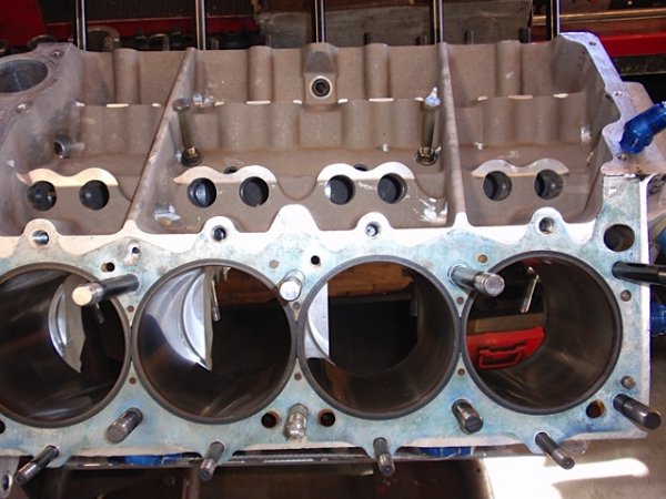

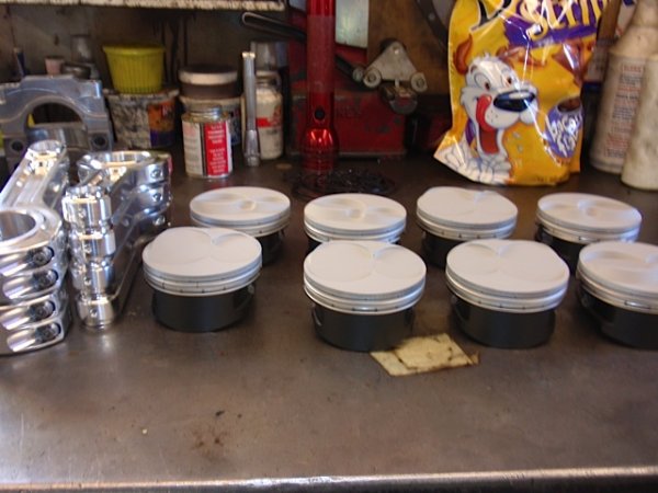

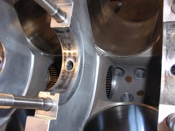

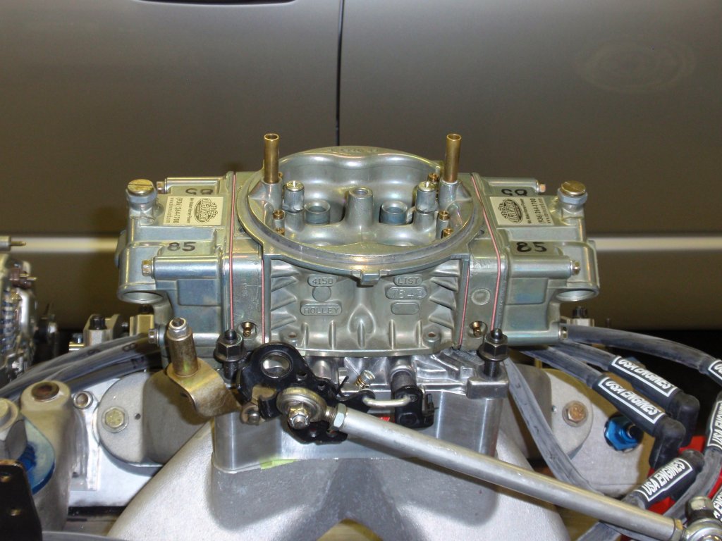

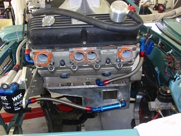

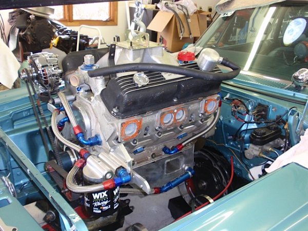

INSIDE MY 427 SMALL BLOCK I USE A DA VINCI 950 HOLLY ON THE SINGLE PLANE W7,W8, W9 INTAKE INSTEAD OF FUEL INJECTION , LIKE WoO DOES. HEADS ARE CHAPMAN PORTED W8'S WITH MANLEY TITANIUM 2.18" & 1.65" VAVLES-370 C.F.M. ISKY TOOL ROOM SPRINGS, JESEL ROCKERS, CROWER BUSHED ROLLER LIFTERS IN .904" FOR A SB2 CHEVY, BULLET CAM .739" LIFT 111LSA. ATI BALANCER, MILODON GEAR DRIVE, 4.OO" MOPAR PERF CRANK, C-P 14 TO 1 COATED PISTONS,4.125" BORE SIZE,
.043, .043,3MM RINGS. GRP (V. GAINES COMPANY) ALUMINUM RODS, 6.456" C.TO C. OLD DIRECT CONNECTION 1 7/8" HEADERS.
IT MADE 755 H.P.@7200 AND 605 FT. LBS. TQ @ 5,500
