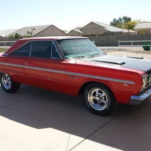

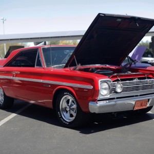

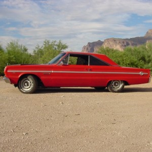

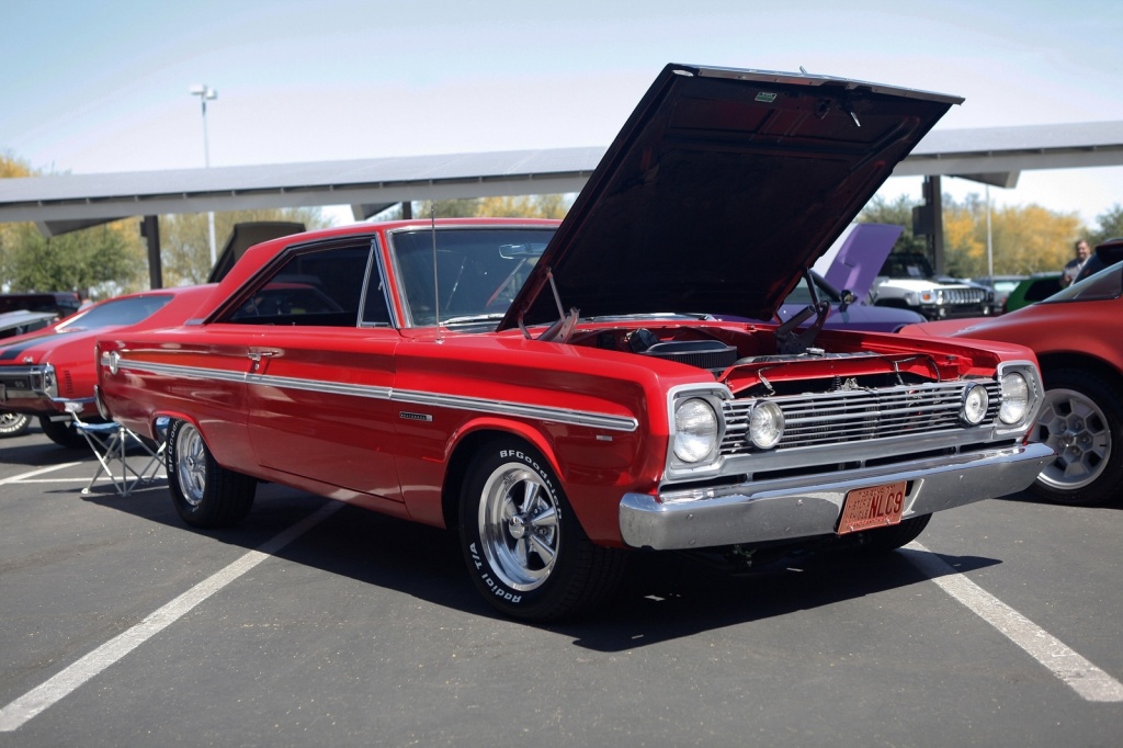

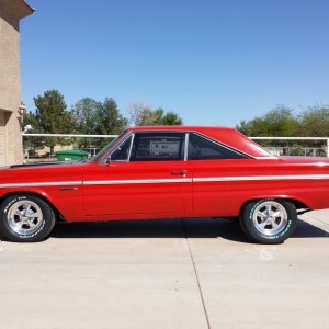

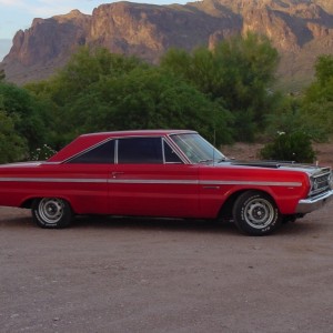

1966 Plymouth Belvedere
Just my home garage with one Mopar.

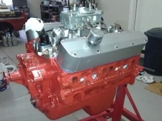

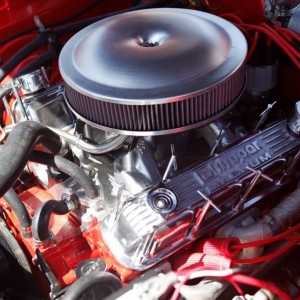

About this Mopar:

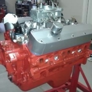

408 stroker (LA 360 w/ Magnum closed chamber heads)
2.02/1.60 valves, mild porting
Comp Cams Nostalgia Purple Plus cam (PN #20-670-4 [94])
Scat 4" stroker crank and rods
Kieth Black flat top pistons
9.7:1 comp
Hughes Engines 1.65 ratio stainless steel roller rockers
Hy-Lift Johnson hydraulic race lifters
Edelbrock RPM Air Gap intake
Edelbrock Thunder AVS 650 carb
MOPAR electronic ignition
Hooker Super Comp Headers
Flowmaster Series 40's and 3" X-Pipe exhaust, turn downs at rear tire
