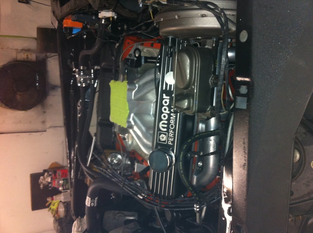

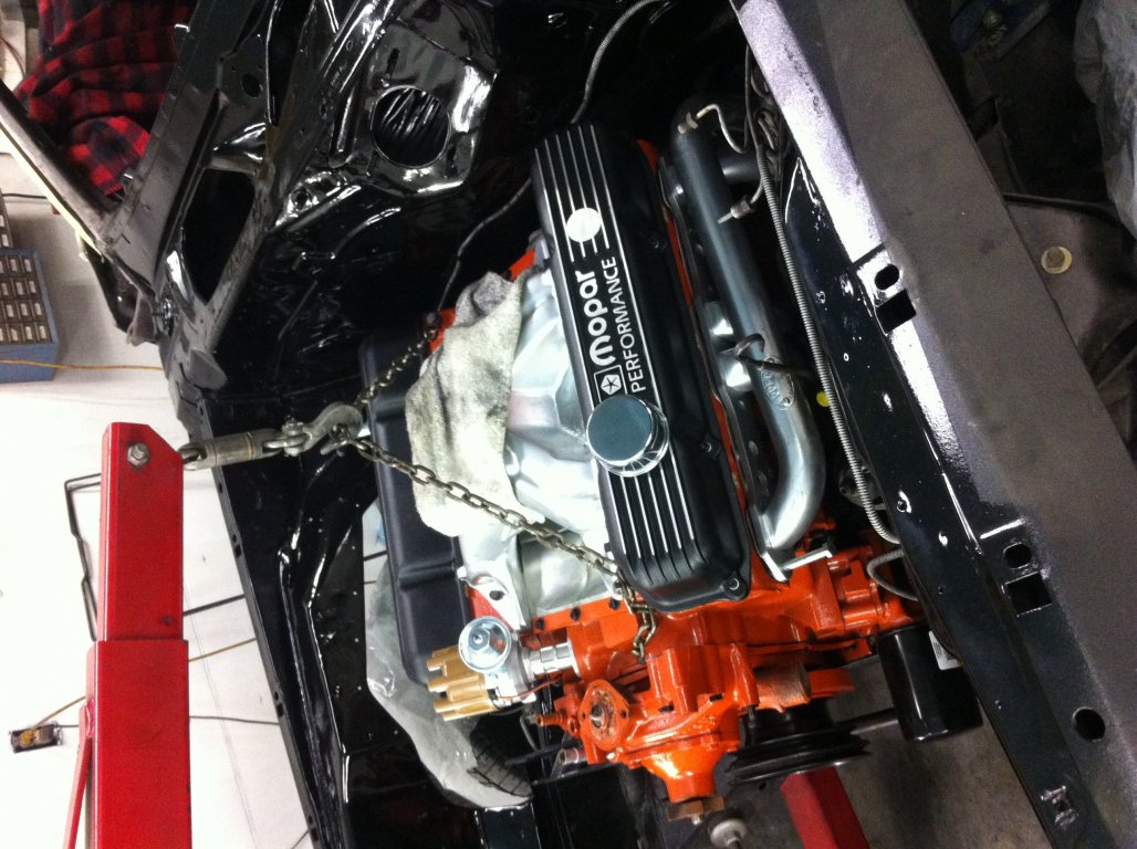

About this Mopar:
1968 hp 440, Indy rebuilt 452 heads with 2.19 X 1.88 stainless steel valves, Hughes engines 1.5 roller rockers, custom pushrods, mopar purple shaft .509" cam, stock forged steel crank, stock rods and pistons, new rings and bearings, quick fuel street slayer 750, mopar performance distributor and orange box, hooker competition headers, and centerforce dual friction clutch.
