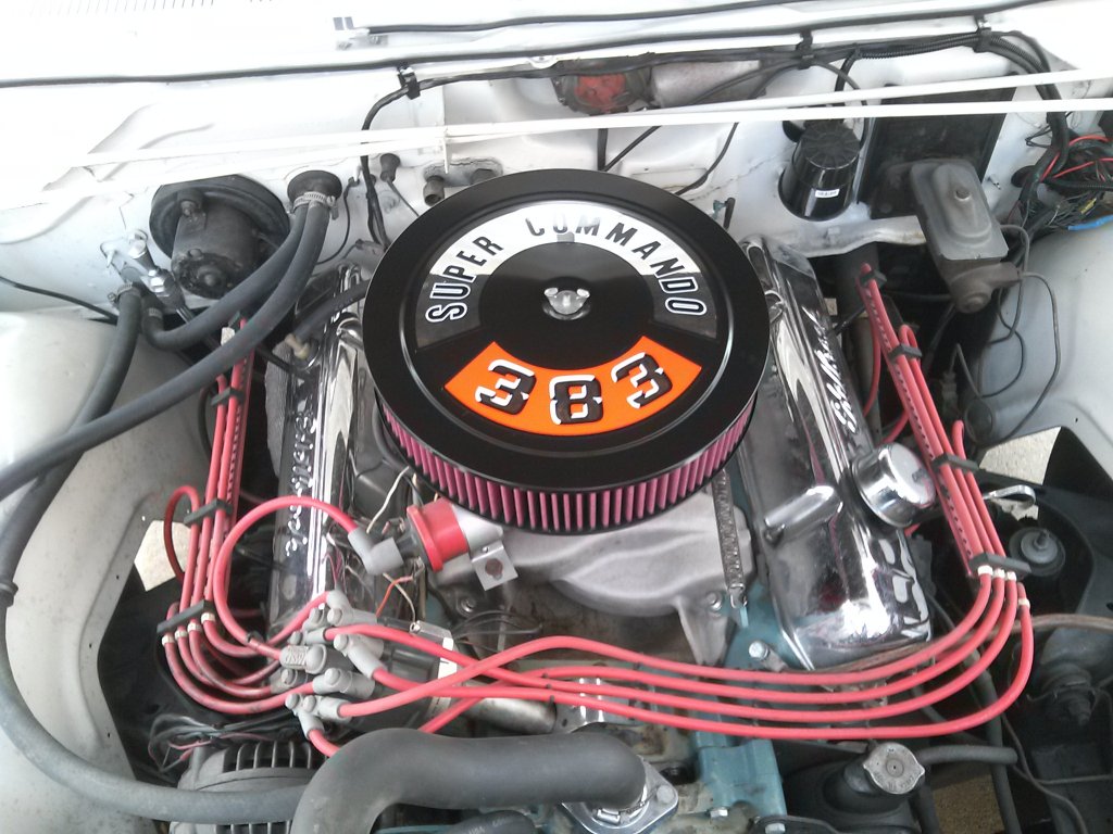

Thanks. Spark plug Wire clips/risers that connect to the valve covers.
They help keep the wires from touching the headers & overheating/burning . I got tired of replacing the boots/contacts on a couple of the wires.
