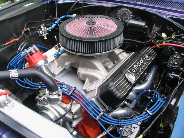

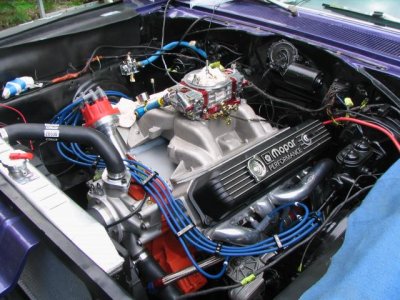

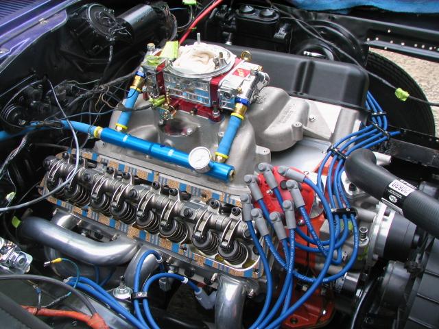

About this Mopar:
1970 Dodge Charger 440 493(C.I) Indy heads & port matched Indy intake, 10/12/67 date code block out of a GTX. Coan reverse manual trans, 3500 stall, 3.91 gear, moser forged axles, holley black pump & 1/2 inch line, 950 carb, Comp custom hyd roller cam 252/254 @ 50 600/630 lift, all forged eagle h-beam rods and forged assembly, 650 HP est. That's about it... left out some details!
