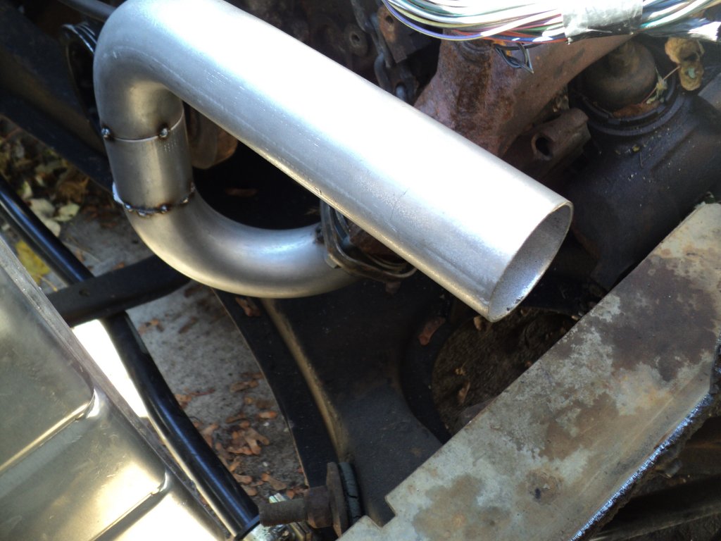

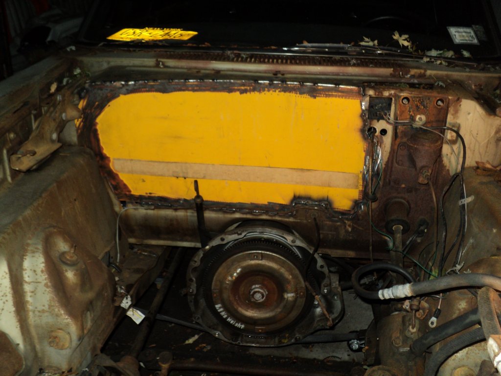

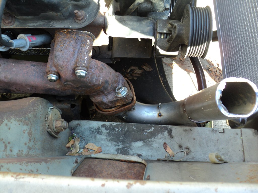

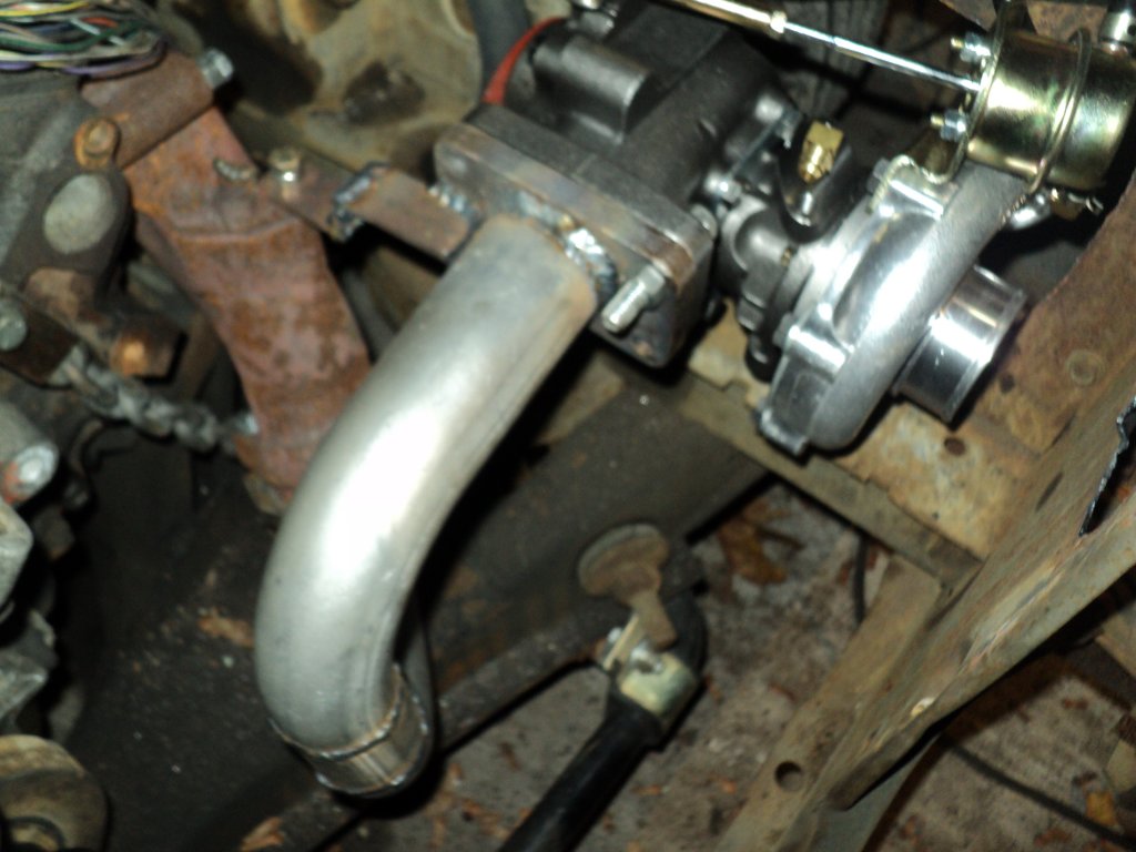

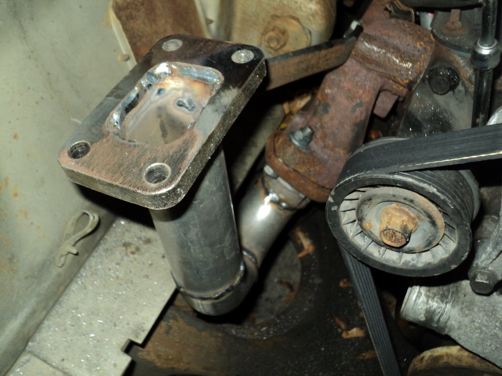

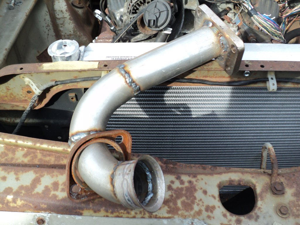

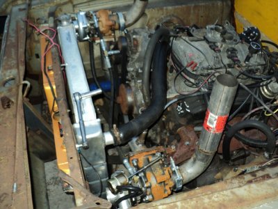

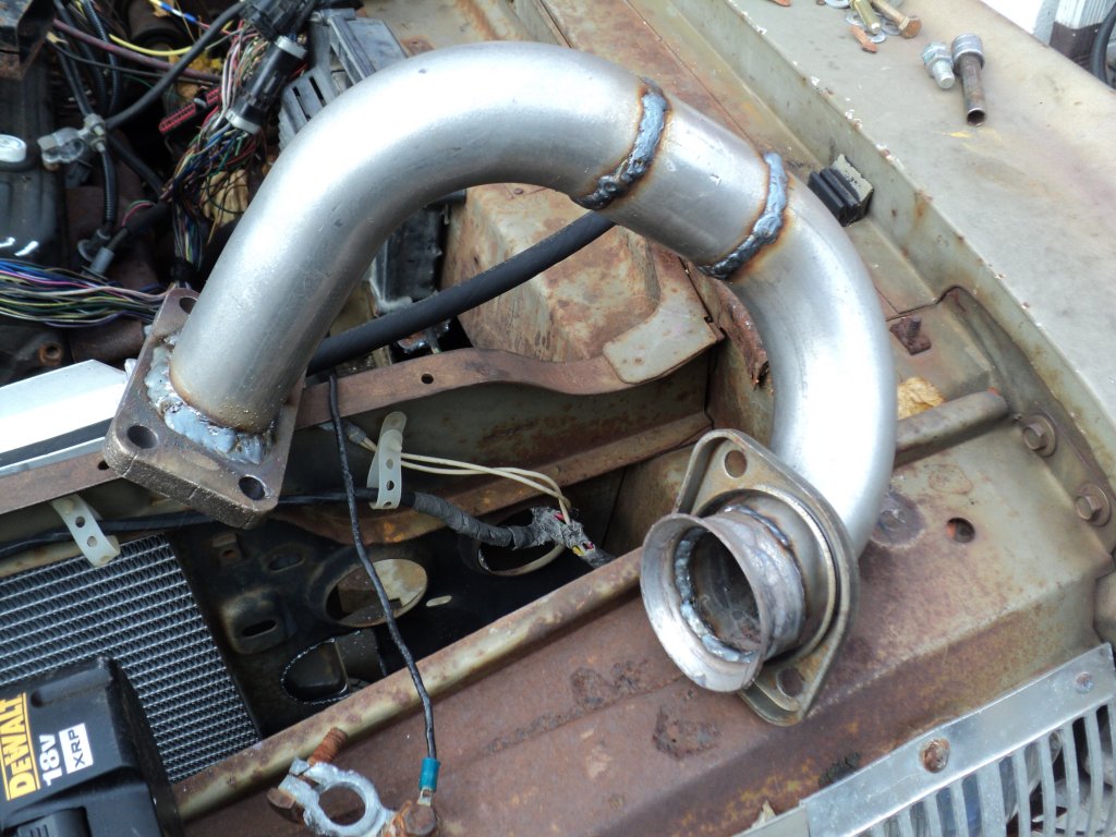

About this Mopar:
Another interesting project, 318 magnum engine, 518 od trans, 3.73 posi rear.
All modern electrics work including cruise control.
Big torsion bars and sway bars, welded 2x2 subframe connectors.

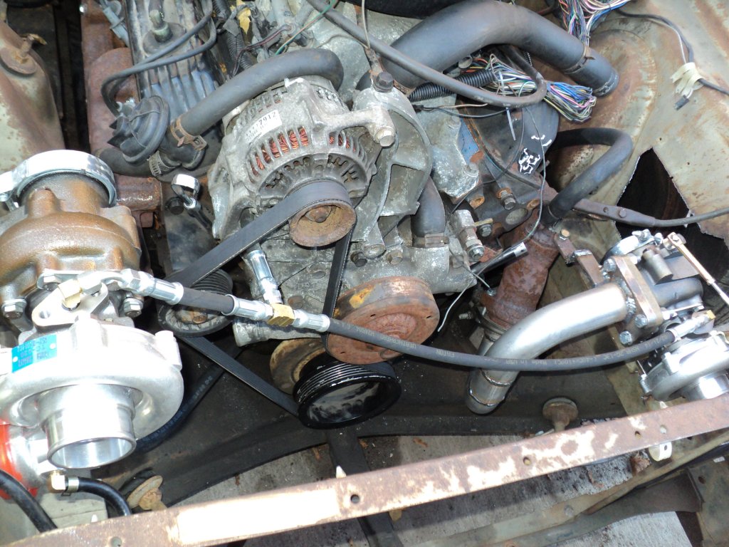

Now comes the fun part, fitting 2 44mm turbos.
Comments
Sweet, the external wastegates will make it a lot easier, as well as the cast exhaust manifolds. Cool project, I like it. What A/R are your turbines?
Thanks they are internal gates BTW, Turbos are ar.42 compressor .48 turbine, They spool around 1800rpm great for the street
