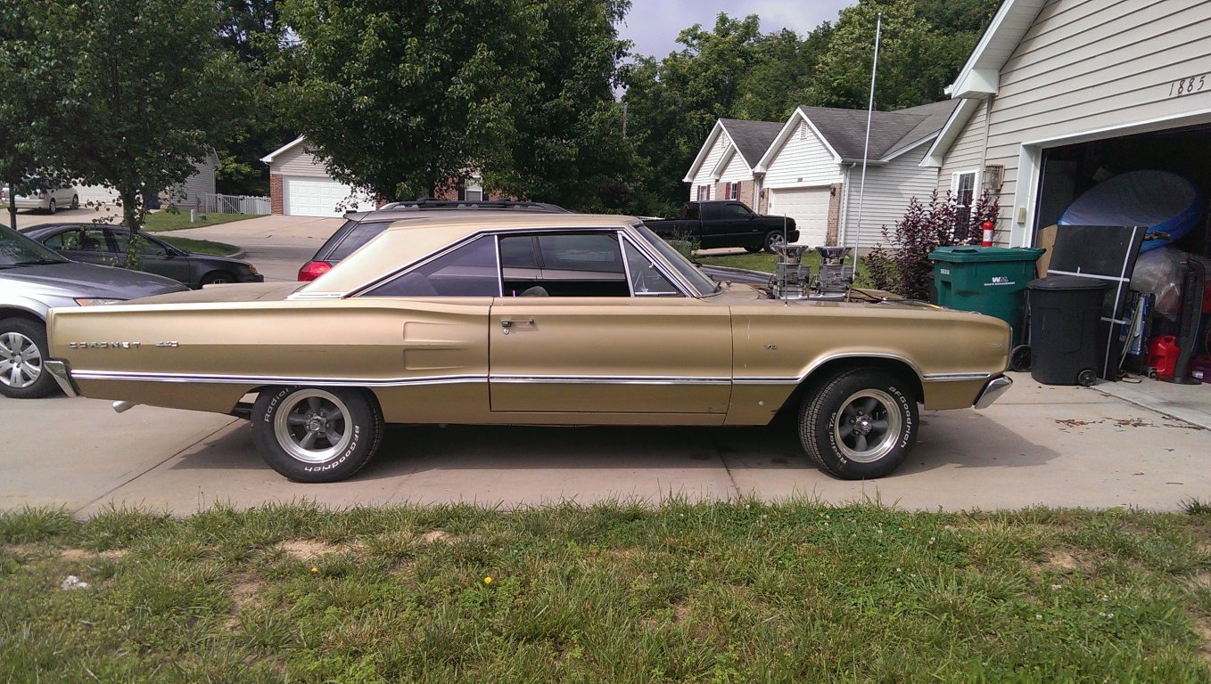

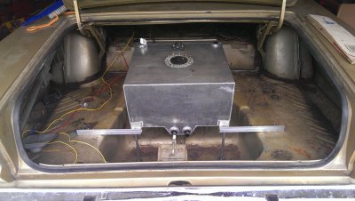

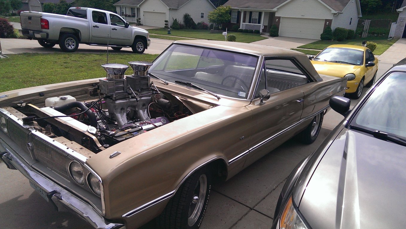

73 440-3 from a Winnebago with 30k miles. Pistons are .120 in the hole. makes like 8.2 to 1 compression. Then just bolted on a bunch of stuff from there. Hughes Whiplash cam, Edelbrock 84cc heads, MSD ignition. It has been disassembled all summer pretty much as I keep "upgrading" junk on it. I did make a video of it after I broke in the cam and got it tuned fairly well. You can see it at
