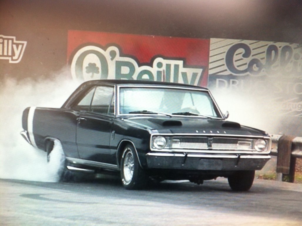

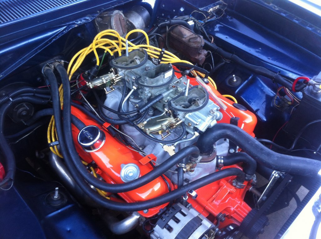

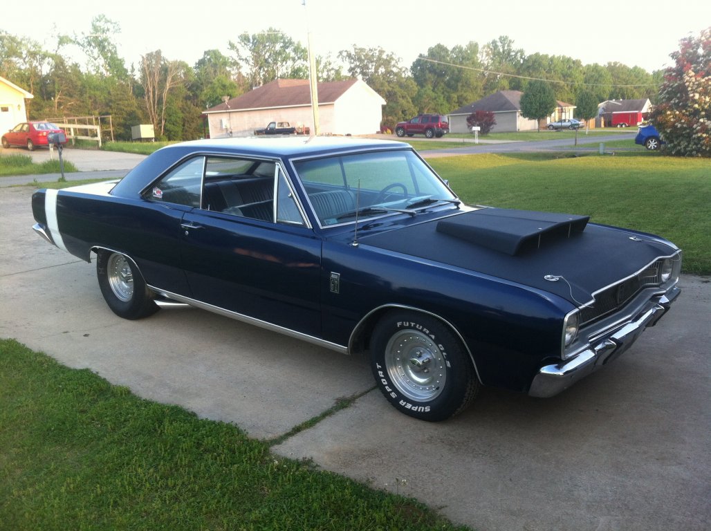

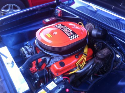

It's a pretty mild build, stock cubic inch/crank/rods, flat tops, mildly ported X heads, mopar 508 purpleshaft cam....its the 4.30 gears and 4500 stall that helps. runs 7.70's 1/8th mile @89...i run at a 1000ft track it goes 10.00 @101
