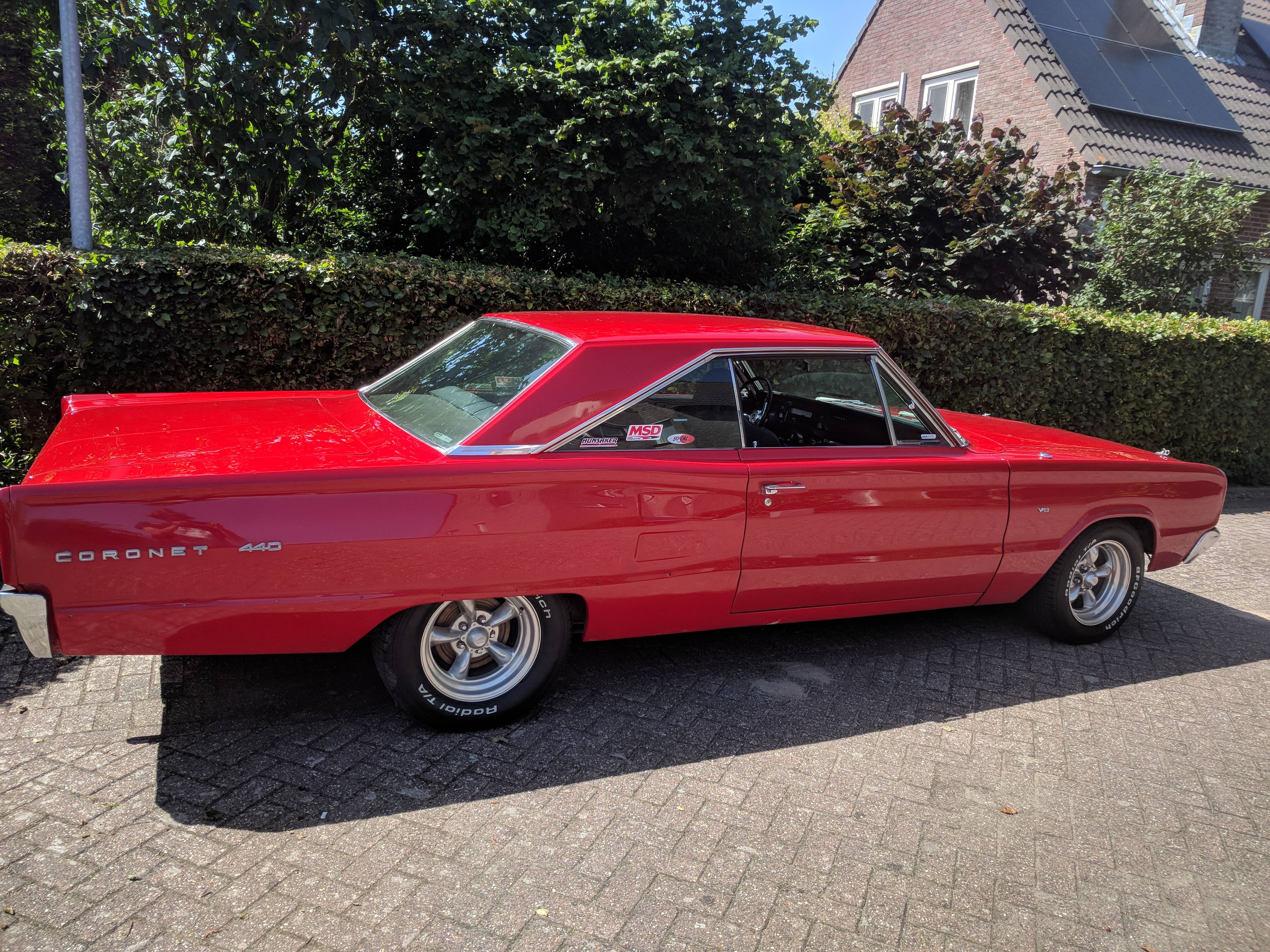

I also drove a wedding which resulted in me getting some real nice pictures of the car. As promised, some pictures of the backroads here in the Netherlands!

Nice pictures, glad you got it off the jack stands ! :thumbsup:
blue69runner
blue69runner
Grate looking car. Good to see your getting to enjoy the drive. :thumbsup:
