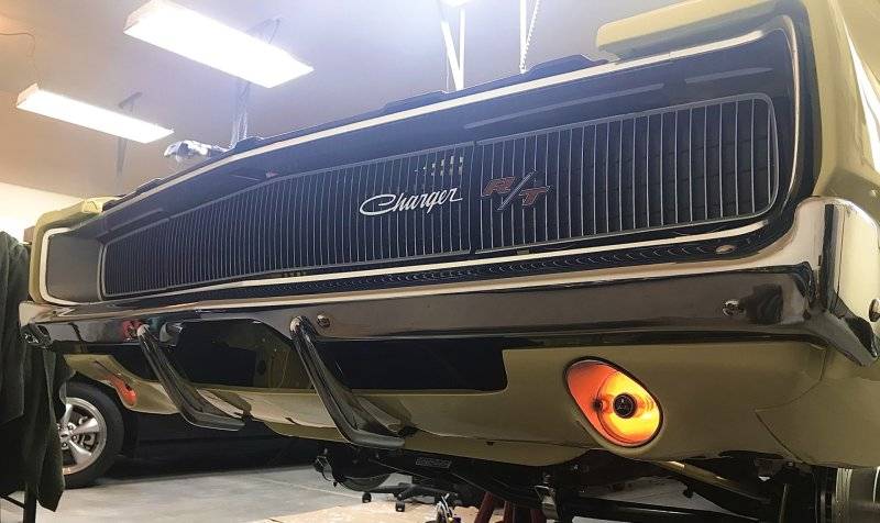

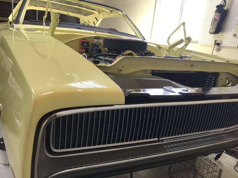

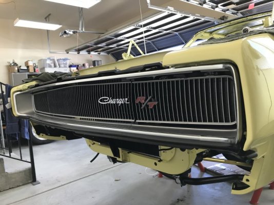

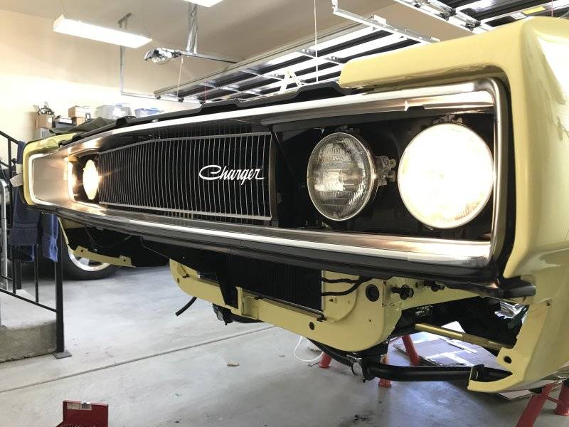

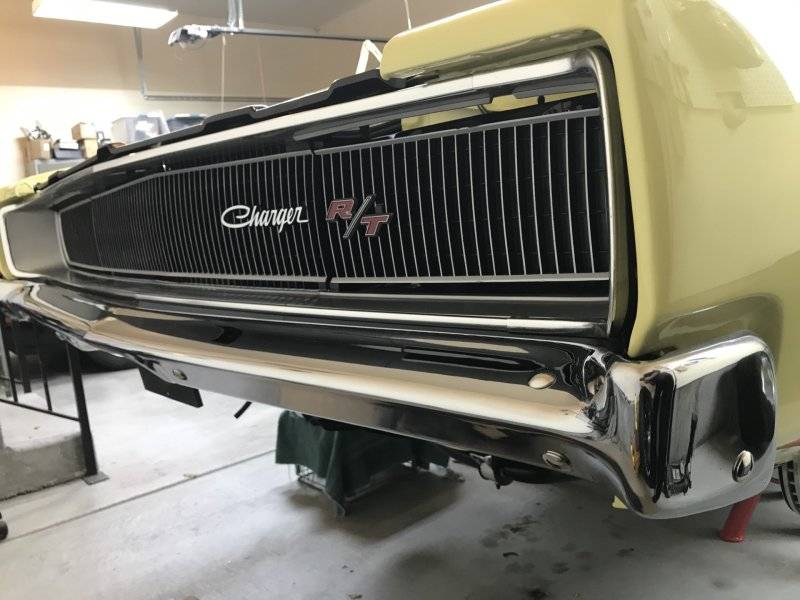

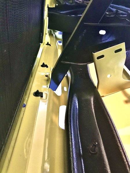

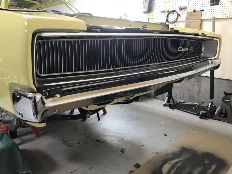

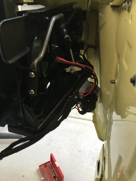

Getting around to fitting the grill in my Charger. Checking clearances for the electric headlight door motors, wiring etc. The kit only required minor adjustments, the control box mounted in the same spot as the vacuum canister, just had to make a bracket so it would be attached at the same points as the factory canister. I like the doors opening at the same time, no lazy eye. Overall pretty happy with the system.
