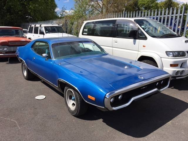

My lovely satellite has arrived from the USA ....

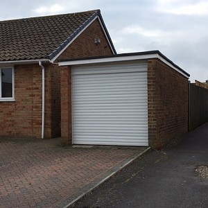

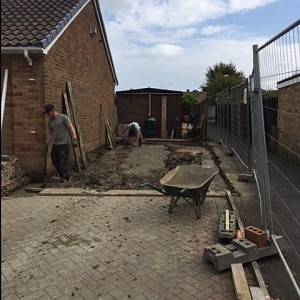

Slight Problem, my garage is too small ....
Hold on , I've got an idea .....

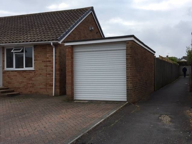

New Garage now completed apart from power and lighting ...

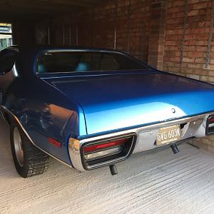

After a few tangles and set backs with the registration process my satellite has finally come home yesterday and is complete with new U.K registration number ( and a huge thank you to all at the DVLA for your help and number plate- in the UK we are allocated a year related plate - 1972 is a 'K' prefix- my initials are GVG I was born in '63 - I couldn't have wished for a better number , the car came from a true North Carolina gentleman ...

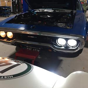

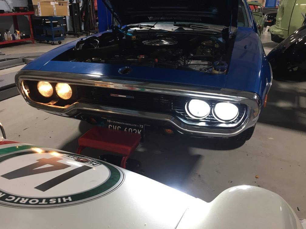

New pic = LED headlights being installed , list of “pre Christmas jobs to do “ now coming close to finishing .
So far - new indicator column camber fitted , Fit new headlamp glass units x4 and gained small ‘ side light ‘ inside new units then LED headlight upgrade Done , stop \ tail LED upgrade done , modified 1972 reverse ‘clear section’ lamp housing now single LED bulb with twin aspect orange +white LED indicator & reverse done, new electronic indicator relay done. Rewire front wing orange markers to become LED indicators and rewire lower front orange lights to become indicators - now have LED orange ‘side repeaters’ and front lower orange as LED indicators . modified to fit new heavy duty HT leads fitted to clear manifolds and steering box. Original 46 year old ‘birds nest ‘ wiring traced under dash and engine bay and gone through front to rear end - cut out old crap tested/tidied/labelled . Aftermarket stereo removed. Drivers door pillar old broken / worn hinges removed / minor corrosion around hinges / treated /new putty / painted /sealed . New drivers door hinges fitted / painted / drivers door realigned all done .

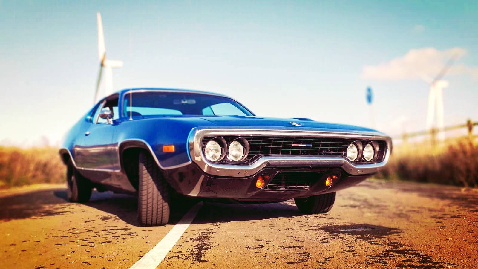

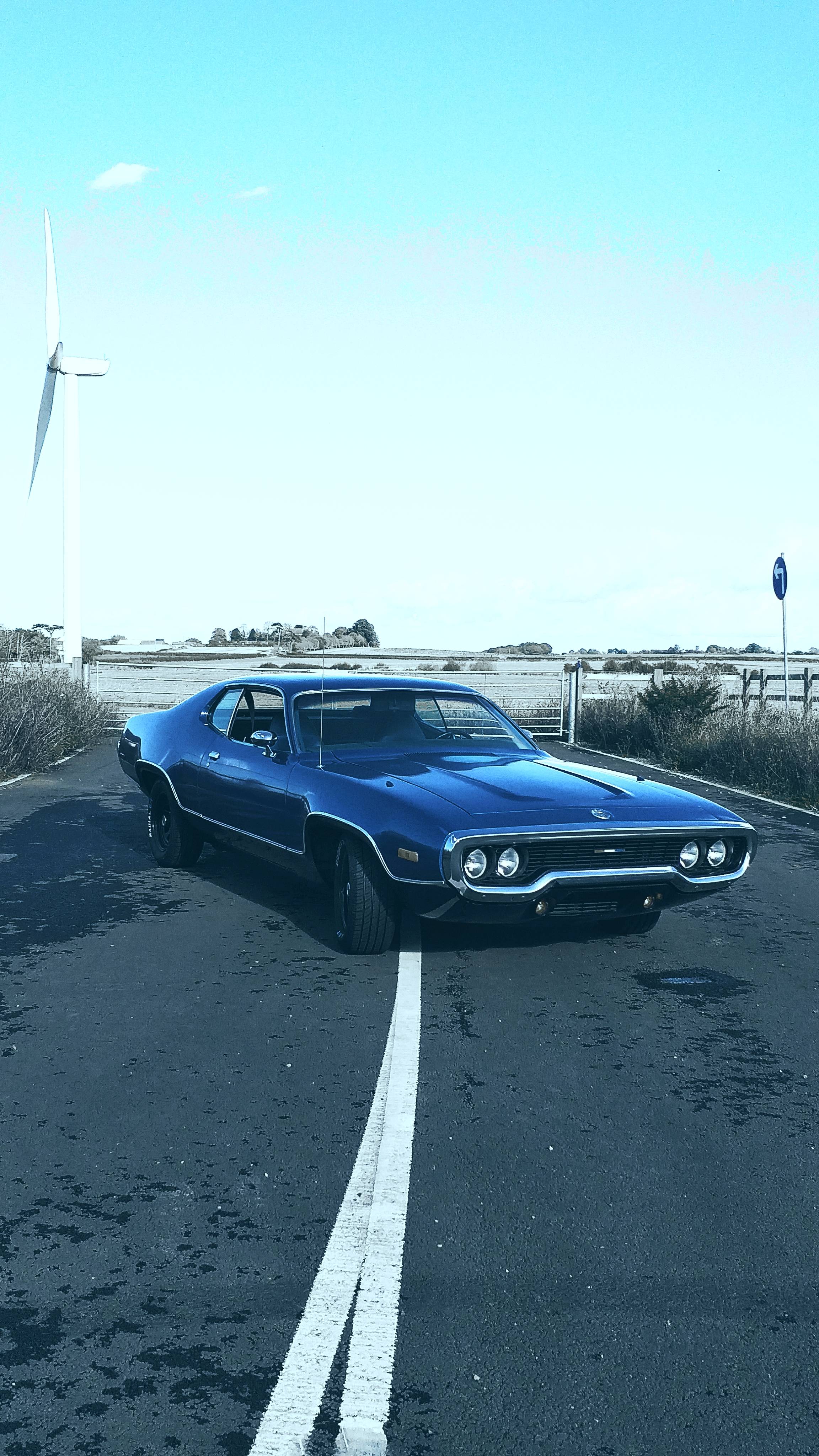

Added a few pics today as summer 2019 is coming to an end ...and I thought I'd take a few local ish ones ....
