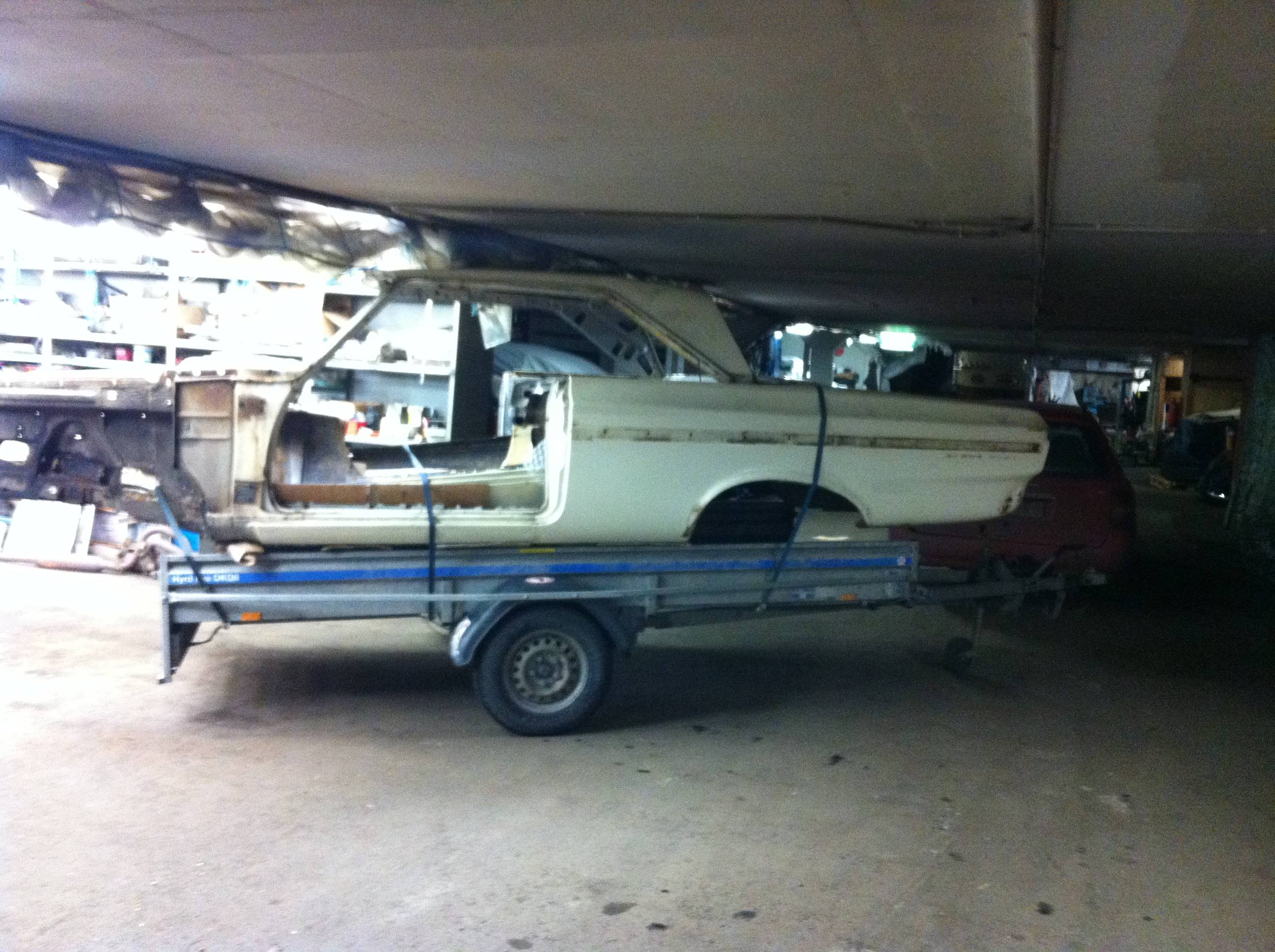

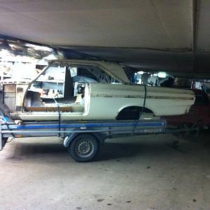

I'm trying to do everything as close to original as possible and I'm using the original parts, bolts and nuts as far as it make sense.
Due to winter driving in Sweden the first years and without proper rust protection there have been quite some work with the body.
I you see anything that diverts from original, please let me know.

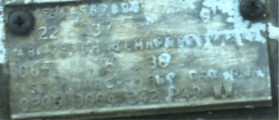

VIN: 3441189021
3 = Plymouth V8
4 = Valiant Signet, Sport Fury, Polara 500, Dart GT, 300J
4 = 1964
1 = Manufactured at Lynch Road , MI
189021 = Sequential Numbers
1 2 3 4 5 6 7 8 9 0
2 2 1 3 7
A B C D E F G H I J K L M N P Q R S T U V W X Y Z
0 6 5 5 3 8
06 = 383 ci
5 = AT ?
5 = AT ?
3 = ?
8 = ?
SO NUMBER BDY TRM PNT
0205 9004 342 P4R WW
0205 = Scheduled production Feb 5th
9004 = Reminder of sales order no
342 = Plymouth V8 Sport Fury 2 door Hard Top
P4R = Premium level bucket seat in vinyl, Red
WW = Chrysler White Code DT1263

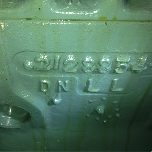

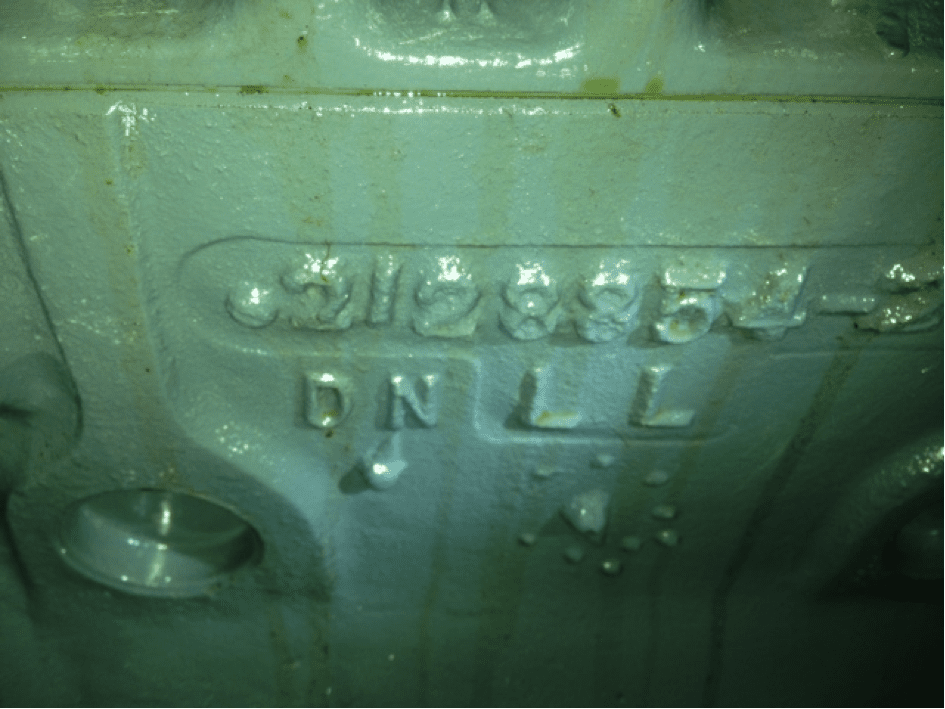

Engine
Casting no: 2128854-2 = 1964, 361 or 383 B-block
L * L = Left Line (Production Line)
12 * 4 * 63 = Day of casting Dec 4th 1963
DN + ”cast watch” = casted 5 AM
Stamped, right side in front of cylinder head:
V 38 plus the Maltese cross
2 3
HP
V = 1964
38 = 383 ci
Maltese cross = 0,001” undersize bearing shells
2 3 = Feb 3d
HP = High Performance

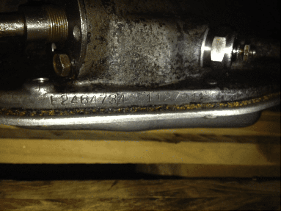

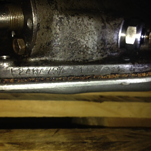

Automatic Transmission
Torque Flite 727
E2464734 112/911
E = Production site Los Angeles ?
24 = 1964
64734 = Part number i.e. code for build-up
112 = 112th transmission assembled that day
911 = Date of assembly, Saturday Jan 25, 1964*
*The 911th day after start day of counting. The 10000 day calender started with code 0001, July 29,1961.
There will be more history of the car, e.g. what day it was sold in Sweden to an TV-serie actor. There have been in total three owners.
Sine a couple of years I've made a "total" overhaul, i.e. from dismantling the washer fluid pump to the automatic transmission. Every single bolt is brushed and painted. The original fuel line is blastered and painted etc, etc ....
Maybe it can be classified as stupidity to put all that work in saving original parts when it is cheeper and quicker to buy replicas but it's like a meditative project doing this.
When it comes to weather stripping I have chosen new productions before NOS due to the ageing of all rubber and plastic products. I don't trust 50 year old rubber even though it has been stored properly.
Most of the parts that is not original are the ones inside the engine and transmission and external easy to change parts for the next owner who wants to ride around with e.g. diagonal tyres. :)
