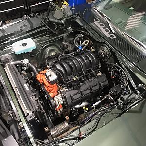

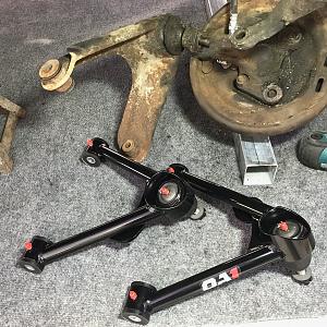

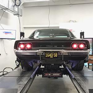

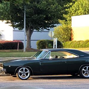

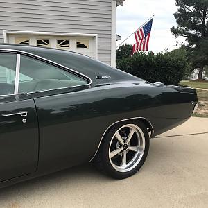

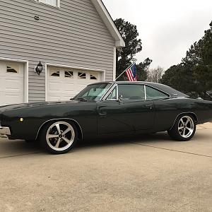

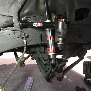

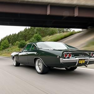

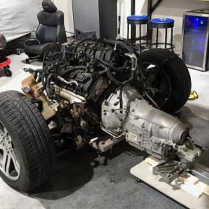

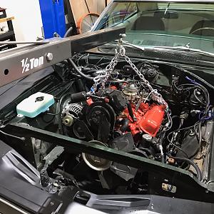

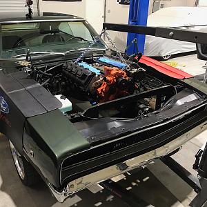

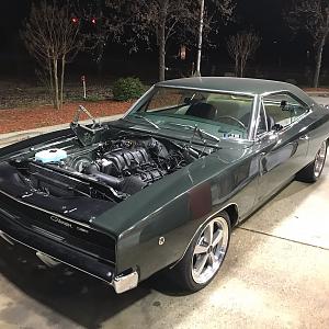

Picked up my 1968 Charger in December 2020 from the original owners. Follow along with my updates of upgrading/modding it to be modern with a GEN III HEMI Swap and NAG1 auto transmission from the original 318-2barrel and 3 speed auto (904).
About this Mopar:
- Year
- 1968
- Make
- Dodge
- Model
- Charger

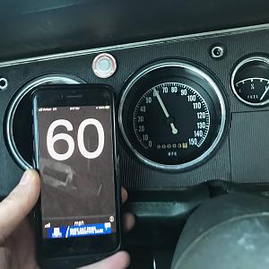

Purchased from the original owners in Dec 2020. Since then I have installed a 5.7 Hemi engine and 5 speed automatic transmission. I rebuilt the rearend with a Sure-Grip positraction and 3.73 gears. Running a Holley Terminator-X computer system, Hellcat injectors, and Aeromotive fuel system (340lph) it runs on E85 and makes 335hp/390tq on a chassis dyno. After 2 sets of wheels, I finally decided on the American Racing Vector VN-47 wheels (15x7 front and 15x8.5 rear).
