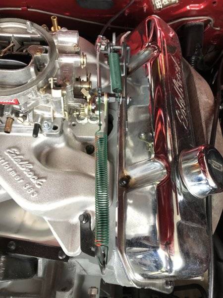

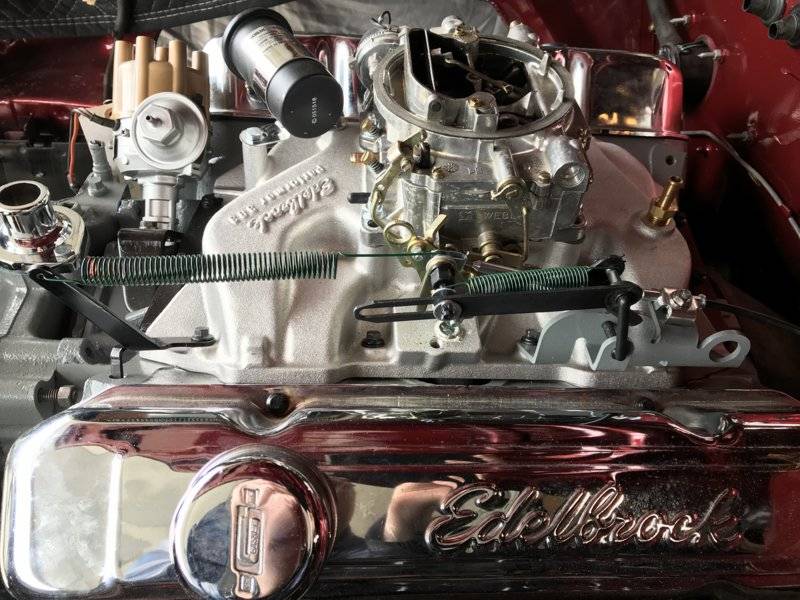

Hey there experts, I was wondering if I could get a second set of eyes on whether or not I have my throttle and kickdown linkage set up correctly. 400, 4bbl Edelbrock, 727. I still need to install the throttle rod, but I am hoping I am on the right track!
That would work but typically the pivot is installed from the inside and the flat piece is on the carb side with the spring on the outside.
