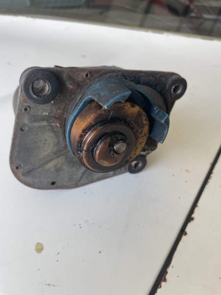

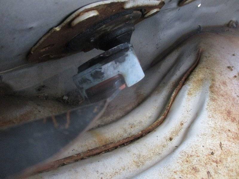

Below is a picture of my wiper motor for my ‘79 Magnum. Notice the broken part. It can be removed easy enough I guess. (LOL) But, the name of this part and part number I could t find in my factory books.
Can anyone help with a name, part number to obtain one of there even on a dealers shelf somewhere, or, have one that I can purchase?

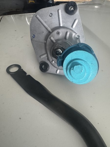

This is a common issue for 78 -79 Magnums and Cordobas. You won't find NOS, and if you did they won't last due to brittleness. Here is a Facebook Marketplace link for a fella who is now 3D printing them. He also 3D prints the rectangular white interior light lenses for the cars too. He is a member of the 78 -79 Dodge Magnum Owners FB group. 76-79 Mopar Wiper Cams
Awesome! Excellent! Thanks a bunch.
I was just going to post about the recast wiper cams. As having used one, they're great and not too hard to install
