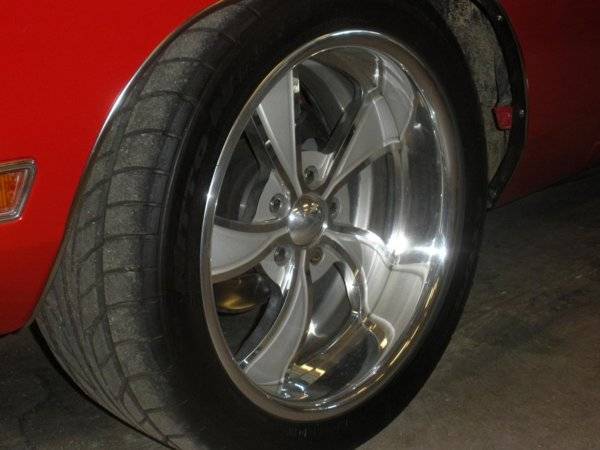

The tires on our 2015 are 245-45-20. The rim is 8 inches wide. I have 275s on a 9 inch rim on the Charger. The tread sits square. I don't mind a tire a bit wider than the rim, it actually can protect the rim edge should you scrape a curb. I'm not sure of the width of your rim or the tire size you currently have but if a 275-40-18 is available, it is about 1 1/4" wider than a 245 series tire.

How wide is the rim? I have 275’s on my 06 Charger, next time around I’m going 295’s
Running a tire with bead wider than wheel contributes to sidewall flex. Look at Formula cars, wheel is always wider than tire bead, helps to keep the tire from folding over onto sidewall under cornering pressure, increases directional stability.
