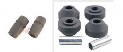

Has anyone put the 2 piece strut rod bushings on the stock '62 strut rod arms?
The '62 service manual shows the 1 piece design on the left. With the sleeve I bet the later design may work better. Even though I asked for the bullet shape, PST sent the others. I will keep them and intall them if they will fit.....

Put O.E.M. one piece in my wagon,one split after about 6 weeks,the reason being that they were 40 + yrs old.I have two piece in now only because I had them or I would have used new one piece bushings.One piece worked for decades,only drawback is they can be a pain to install,make sure you lube them well.

Thanks buddy - yea old NOS rubber parts - not such a good thing. Bought some NOS rubber wiper blades, good thing she doesn’t go out in the rain. I will say one thing, this PST “PolyGraphite” is some tough material - dense and slippery. PST does have the bullet shape strut rod bushings in the “PolyGraphite” too they told me.

I put the single bullet shaped poly strut rod bushings in there from PST, correct for ’62. But the threads bottom out way before the 40ft lbs of torque specified.
What came out of there was an hour-glass shaped single piece, and actually hollow!
But the 2pc that PST sent with the sleeves do not fit my wagons .72 dia strut rods. The Moog K7039's with .714 ID are correct, and Firm Feel confirmed that. Will mount them with the convex side of the washers against the bushings.......
