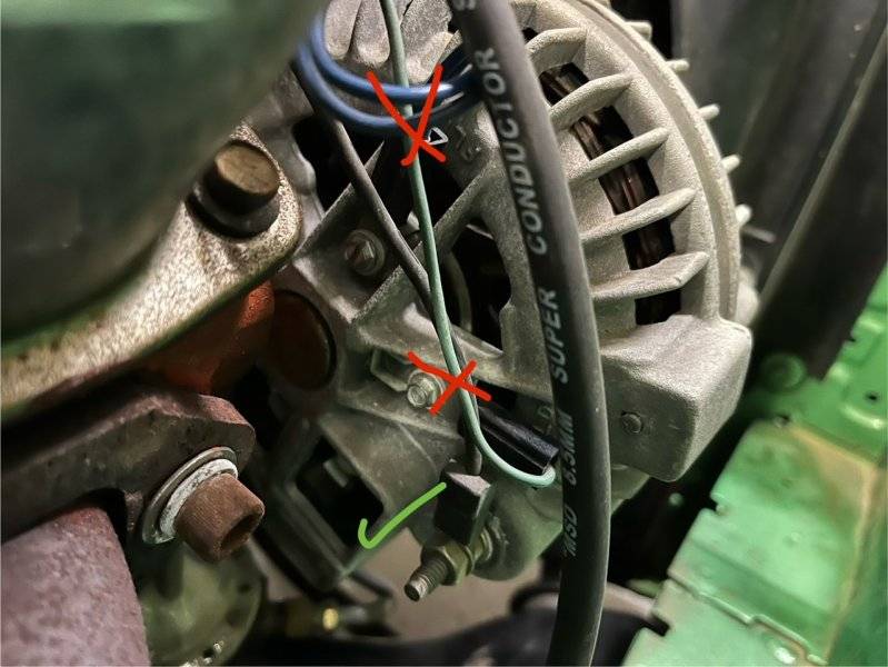

hey guys, im replacing my failed stock alternator on my 69 Coronet, I have a new 1 wire Powermaster and Im looking for some guidance on what to do with the wires from my old one, (one green, two blue on same terminal, and the ground.) Im going to run a 4awg wire to my starter lug that shares the + battery cable, and reuse the ground cable? . Would I just be bypassing and/or removing those green and blue wires ? is it really that simple? feels like a trap lol thanks guys

I still have a question about the ground cable and ammeter though, it doesnt say the ground cable needs to be altered but in my own opinion it wouldn't hurt to just run a heavier grounding cable? as for the ammeter/alternator gauge will that just no longer function or what wire monitors that? If anyone has experience with these Powermasters I would greatly appreciate your input, thanks

The Black wire going to the ammeter also is not a ground wire.
You don't need any ground wires to the alternator.
