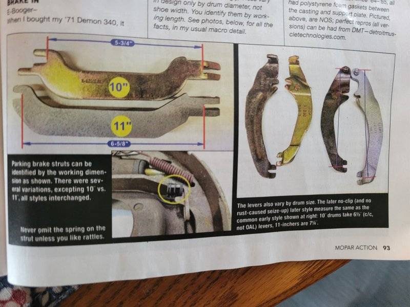

10 x 2 1/2 ebrake levers and struts are the same from 65-87. b body, c body, 73 up a body, volare, aspen, rear drive 5th ave. anything that has 10 x 2 1/2 rear shoes. only difference is that early levers have a pin that slides into the shoe and has a horseshoe clip holding it to the shoe. later ones are inserted into the shoe and held by no clip at all. here is a pic of 10 and 11 inch stuff. thanks rick w.
