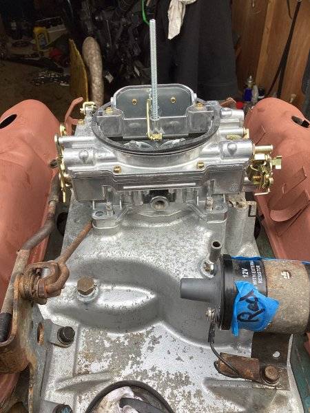

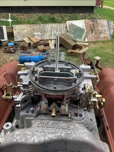

Mostly carb questions. I am reading the instructions so have some things figured out.
Which way around does it go? Does the Edelbrock badge go to the front. If so part of the controls hit the inlet manifold, and I would need a spacer about 5/16. I will study the setup a bit more tomorrow. I will use a push / pull cable for the choke. I need to study the 1481 adaptor, once I get the orientation correct. Any tips will help.

Some pics so far.
Badge goes on front.
Myself, I only torque to 95 lbs.

Yes, spacer so the fast idle cam link clears.. Looks like a big vacuum leak if you don't plug the hole in the back of the carb...

Thank you men. I will study it some more today. With the instructions I should get most things figured. Will know more when it is back in the van. Doig a test fit now, and will probably remove the intake manifold to obtain a bit more clearance when installing the 318 and 727 back in the van.

They make an electric choke kit for the #1405. Basically makes it a #1406.
