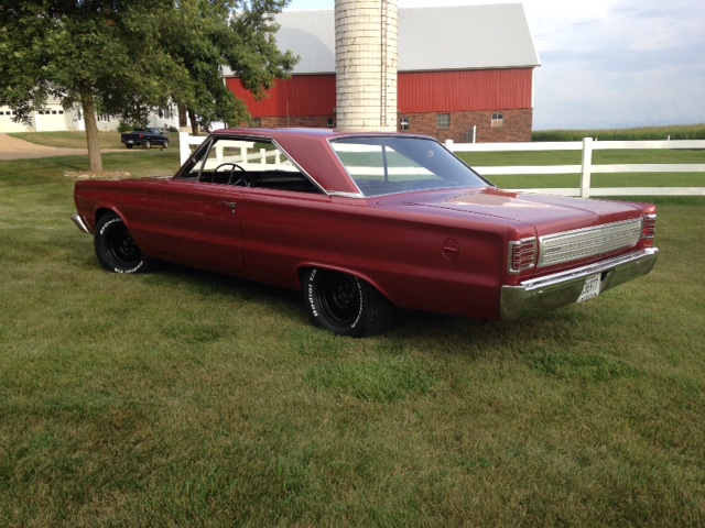

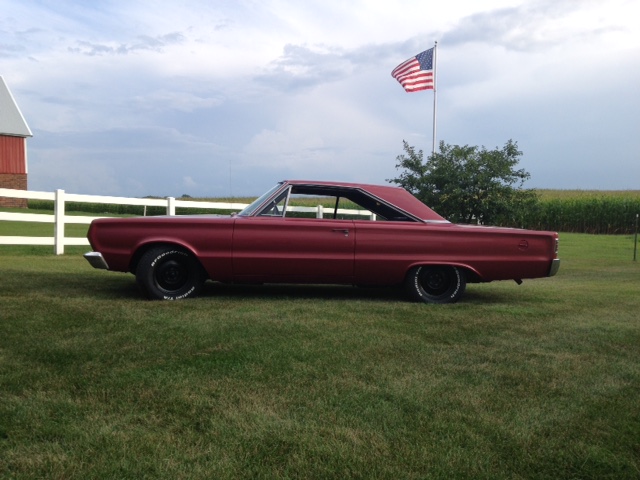

15x7 all around 24560x15 on rear, 23570x15 on front, close to rub, also would recommend ta's for stiffer side wall.
