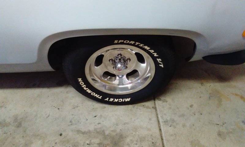

4 l/2 back spacing. Will they fit? Planning on running 215/70 tires on them

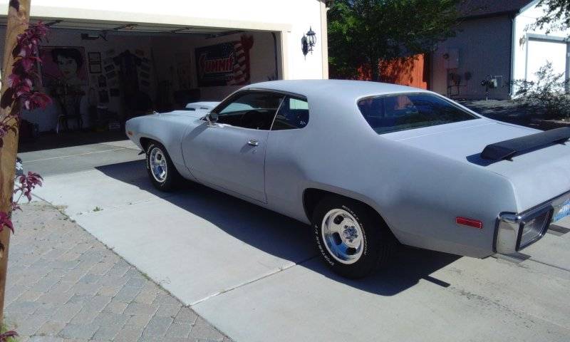

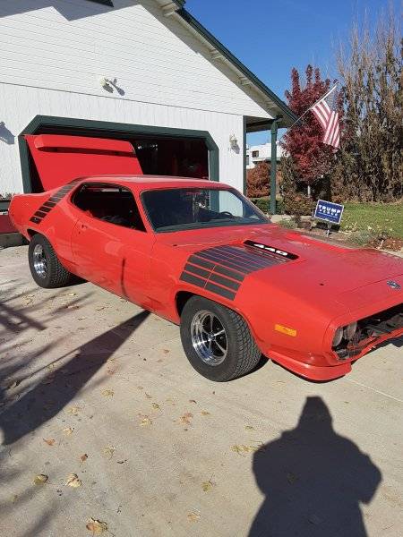

I have a set of 15X8 4.5 back space that I took off a 73 Satellite with P255 60R15 tires all around. They fit fine. Put them on my 72 until I got my strip matching gold wheels done. Picture is of the 73 after we removed them and put Gold wheels on it also. Second is the wheels we had on.
Curious why the OP would want 215 tires on 8 inch rims.
I have 215 tires on 5.5 inch rims, and 255 tires on 6.5 inch rims.
Not to mention they must have been a pain in the you know what to mount.
These are 15" 215 70's on a 7" rim. You don't want to put those on a 8" rim....just a hair over 26". I have more wheel opening though I believe. Rear has 15x8 255 60 15.

Was running 15x8 4.5 back spacing with P255 60R15 all around and NO PROBLEMS EVER. My friend is running 15x8 With P295 All around and also NO PROBLEMS
