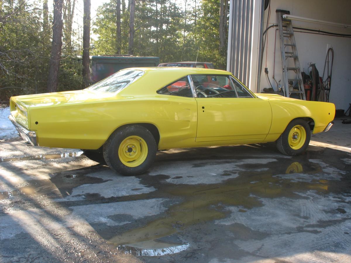

what am I looking for at the junkyard to get 15x8's steelies for b body Mopar...thanks:yes:
