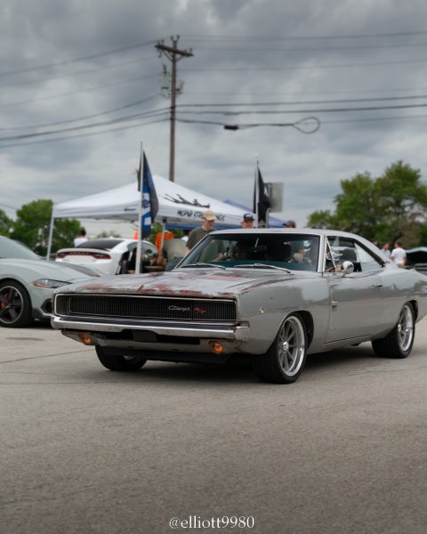

17 x 8 front, 4" BS on my 68 Runner. Clears the frame ~1/8" or so when pinned left or right. 245/45/17 tire.
18 x 10 rear, 4.5" BS. 295/45/18 tire. Diff has been narrowed ~3" overall. ~3/4" clearance inside and out.
