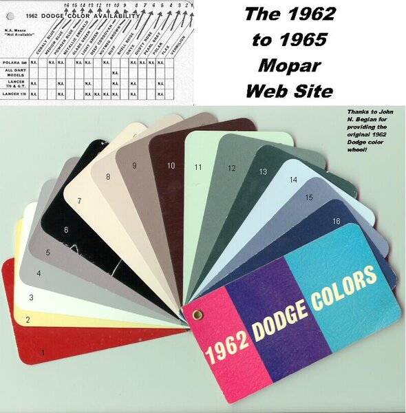

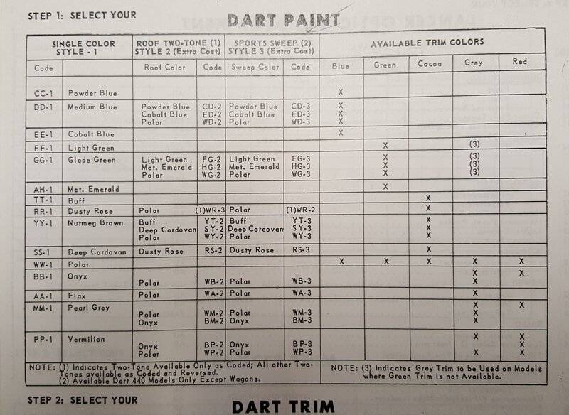

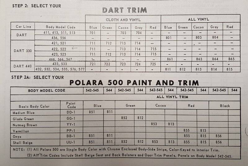

I've never seen this interior with a black exterior. Maybe you might be talking about cloth bench seat of the same color. Don't know why it wouldn't work though. I have different dealer brochures. I'll try to dig them out tomorrow. Most black cars in '62 had red interriors, red and white, black, black and white.
Edit: Must have been the grey on the darts. Black only shows up for the Polara in the selection chart I posted.
Looks like you just picked your paint then picked your interior.
View attachment 1038579 View attachment 1038580
This is exactly what I was looking for! Thank you. I knew someone would have it! I do know that you could order and they would build anything, but there were suggested combinations that the designers knew looked good and would help people from getting too crazy with interior/exterior combinations. Perfect! Thanks again

yes. you are correct. Cocoa was not on the list for black cars. However, I have seen a max wedge creation where they did do black with cocoa interior and it actually looked quite good. The car I am getting is Buff. depending on how it looks in real life I may keep that color (it is original paint) or try Dusty Rose. That is an authorized combination from the sheet you supplied. Ive ordered a color chip so I can see it. Hard to tell if its a silver lavender color or silver pink color from photos.

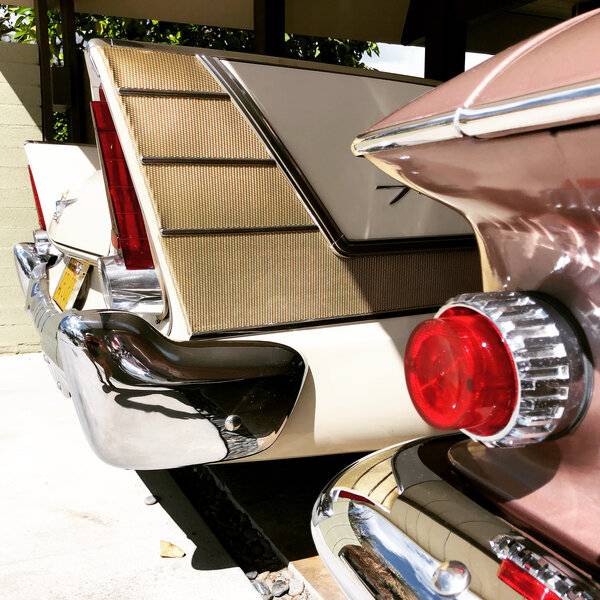

And mint green with red interior.
Factory available or not, I've been thinking on painting mine in the same color.
Mine is white with full on red interior, I thought about painting it blue because I didn't want the usual white, black, red, grey, silver.
Feel free to post more pics of that gem, from any and all angles.

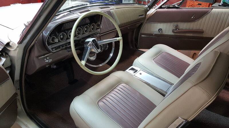

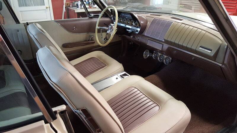

My '62 Polara 500 is the Shell Beige / UU1 and it wasn't available for the Dart. Don't know why. Trying to find the formula was nonexistent. My local PPG shop used their computer on it and still had a hard time matching it exactly. Well they did quite the research and comparisons and discovered a Ford color, Pastel Alabaster that was pretty much dead on. These formulas are long gone with all of the new paints that come along every year. The paint companies delete them over a period of time.
Another color I needed was the Dusty Rose for the interior. This color falls under what they call Cocoa as the interior color. This ended up being another Ford color called Rose Beige. Eckler's happend to have it and it's a good match. I probably could have found it through PPG but Eckler's was selling it in spray bombs and I thought it would be easier at the time. There's five different colors inside this Polara 500.
You'll find that some of the Plymouth colors are the same as Dodge but they use a different name and paint code. Another thing I don't understand.
Here's a paint sample in case you don't have it. (Any photos on this site are not in detail when they are in a post. Click on the photo to enlarge it and see it in more detail)

Thanks for the photo. Shell Beige was unique to the Polara only because they were trying to match the white color on the seat bolsters which was more of an eggshell color. If you ever need to match or create colors you might try this website: https://www.autocolorlibrary.com
This company is in San Diego and they can create any classic car color using todays water based paints. They have all the formulas for both interior and exterior colors. They can make single and two stage paints. They created the paint for a few cars of mine so there is no guessing about color. It's exact!
