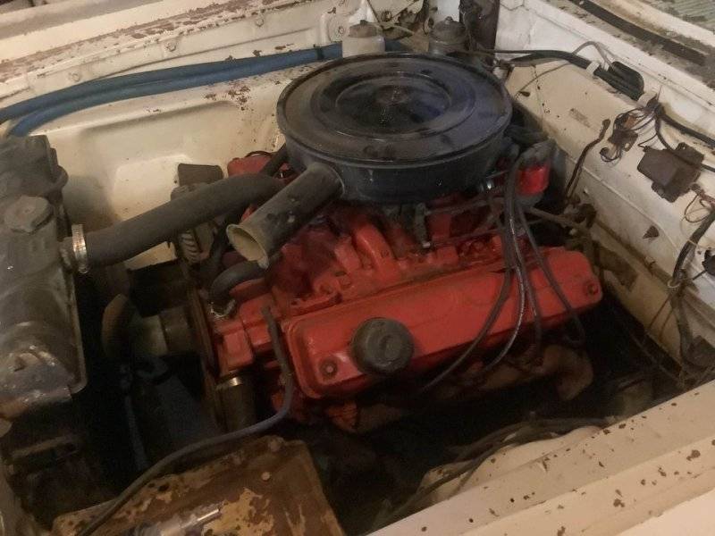

Hello everyone.
I just bought a 64 Phoenix (Australian). The car is in remarkable condition and I suspect it has been off the road for about 30 years going by the last rego lable on the car.
I bought it knowing the engine wouldnt start because the previous owner was 1/2 way through installing a spin on oil filter conversion. When the car got to my
home, obviously the first thing I wanted to do was get it running. So after finishing off the conversion and getting a very dry engine to be ready to turn over and come back to life
I tried to start it. It was backfiring and carrying on but not starting. The previous owner also fitted a new distributor, so I went down the road of checking the timing and re setting it
(it was way off). It still wouldnt go. This was on the first day and it was getting late, so I gave up for the day. second day I double checked my timing set up, removing the left
rocker cover and number 1 spark plug to confirm the timing marks, all good, but still not starting and still backfiring, but it sounded like it wanted to go. I pulled all the plugs, they looked very new
but some were wet and others were dry. This made me pull both rocker covers so I could watch the valves. When I was checking the timing marks, I should have looked at all the rockers instead of concentrating on number 1, anyway, number 7 has big issues. As the engine is turning over,number 7 intake valve is barely moving and 7s exhaust valve is stuck fully open. I tapped the rocker
to see if it was just stuck, but it sounded solid. Time to give up as the car was in the middle of the driveway and it looks like major surgery time so I moved it into my garrage.
That car is heavy to push, I ended up towing it around with my lawn mower :)
Today, we rip into it and see what was the reason it got parked up 30 years ago.

Spent a bit of time on the timing :) Sadly the suspected rebuilt engine is not the case. Number 7 lifters are stuck with both valves open and this is what it looks like with the intake off. The heat shield under the intake is half rusted off. I am surprised it turned over

Kind of interesting engine. It has been rebuilt at some point. It is a 61 block and being here in Australia, I assume it would have come from a dodge as that was what we got for a big mopar here. To make it fit the 64 trans, they cut the ears off the original engine (I think, makes sense if the old engine was totaled) and welded them to the 61 block. It has the correct crank to mate to the 64 trans as well. As for the engine itself, it looks like it has leaked coolant (water) into the sump. It looks like it was from the intake gasket. With the amount of silicone alll over this engine, I am not surprised it sprung a leak. The engine has been left with moisture in the oil for some time,rusting the bottom of the intake manifold, which accounts for all the rubbish in the valley. Everything else doesnt look to bad. I do need to replace big end and main bearings because of some scoring but it didnt hurt the crank. This might have happened when I tried to get it going. The sump has had another peice added undr the oil pump and I still cant work out why, so I will put another sump on it (I have a spare). So lots of cleaning to do, but unles another runner turns up really cheap, this one will go back in.
Double check the bore. 313 Polys were used in Aussie built Chrysler Royals. The bore size is slightly smaller at 3.875".
