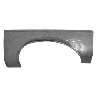

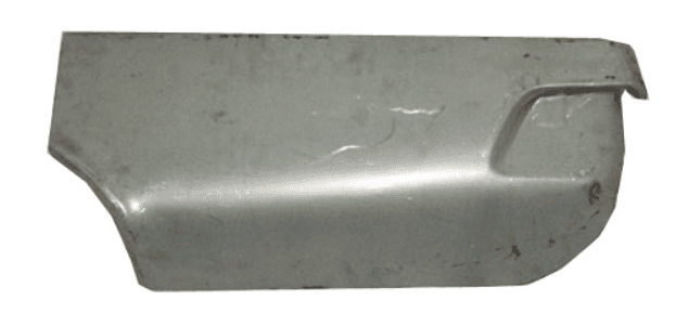

These are available by a few dealers
Where. I can't find them. Old posts online but nothing in 3 or 4 years
I believe those parts are long gone.. I would put an ad on here to see if anyone has some they bought and did not use...
You can check but I believe they are no longer available..
Kramer Automotive
Classic Industries

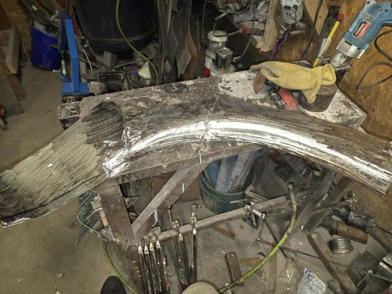

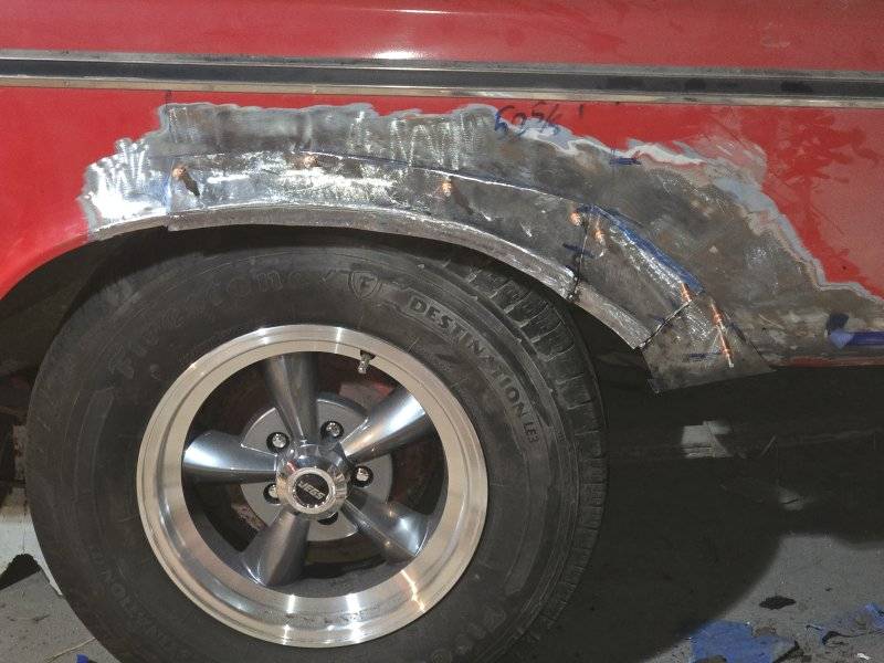

I used the front fender as my buck, here's the new rear qtr rust repair panel. I need to fit it to the car.
