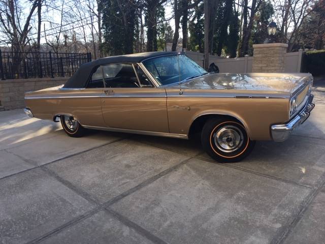

My 48k original 1965 Coronet, 361 2bbl developed some unexplainable nagging issues over the years: 1- very hard to start after any rest even just overnight; 2- reeked of gasoline when back in the garage after a spin (new gas cap and zero leaks anywhere); 3- My dip stick always seems to read overfilled. Various professional mechanics suggested MANY solutions for instance: weak electrical components re: poor starting; install a gas tank vent line re: gas odor: non original engine with wrong dipstick re: oil level. After watching a YouTube video from Austin, host of Obsolete Automotive, it turns out that my fuel pump diaphragm was ruptured and was not only losing pressure but was dumping gas into my crankcase!
