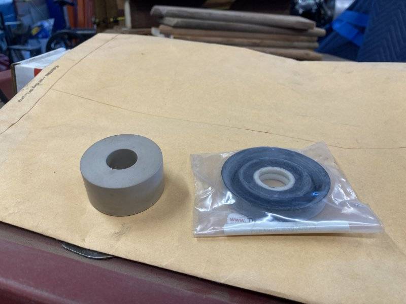

On the steering, there needs to be a roll pin that goes through the end of the coupler intersecting the box shaft. There is a groove near the end of the box shaft just for that intersection. On the other end, there is a seal/bushing that goes on the end of the column tube. Mine was the same. Got a new one, not in yet, plus I had a Delring bushing made to go over the shaft but inside the tube. This will better locate the shaft. Also not in yet. Can't help you on the brakes since mine was manual and will stay that way.

The 65 uses the seal/bushing to keep it aligned on that end. Up by the wheel is an actual bearing. I had that Delrin unit made to better retain that shaft in the center of the tube. Since you need to pull the column at least back some if not out, get a coupler rebuild pack too. Shoes, spring, seal, pins etc.
